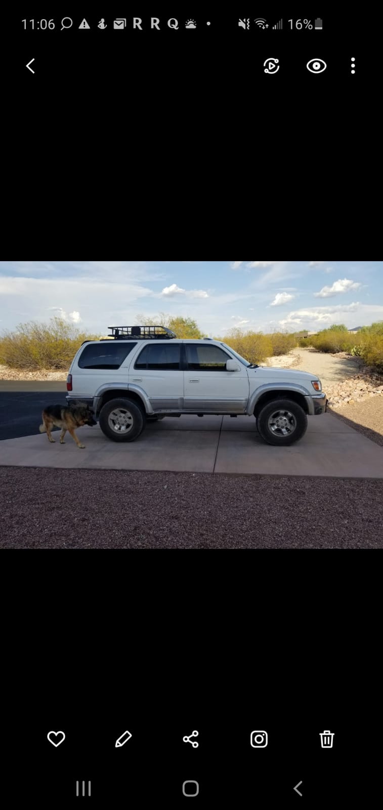

Hey everyone,
You don’t see many that mount accessories to the factory 3rd gen rack.
A full rack is not currently in the budget so I am requesting to see how you all are mounting your recovery boards, awning, shovel, etc.
TIA!
I mounted my awning with the awning mounts that came with it. They are basically L brackets that I mounted to the crossbars.
As far as traction boards I lay them on top of the crossbars and through a strap around them. Simple, cheap, works fine.
I'm sure you could do something similar with a shovel or whatever else you want to mount. Just consider the weight of whatever you do.
I'm honestly just running a low pro yakima box. Fits my traction boards, shovel, and some other random things. Have the box all the way to passenger side. Cvt awning on drivers side also using L brackets. Been fine on stock bars. During winter the awning comes off and angled snowboard holder goes on.
