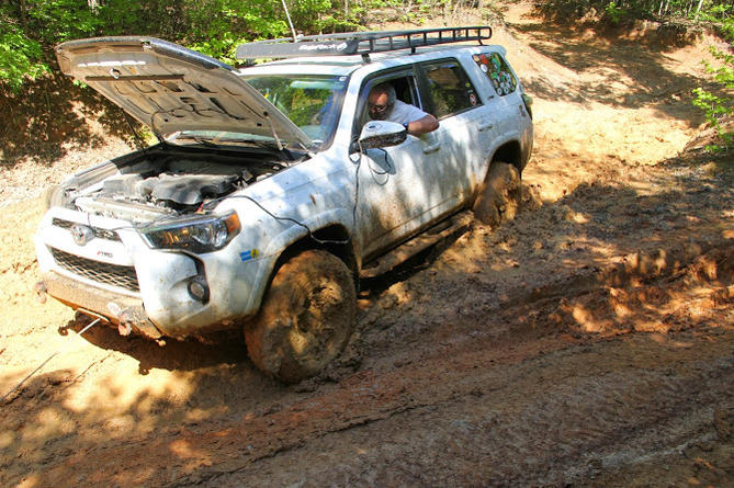

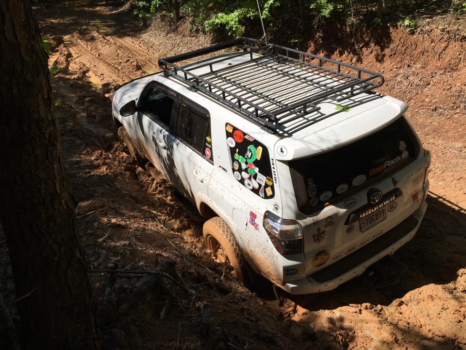

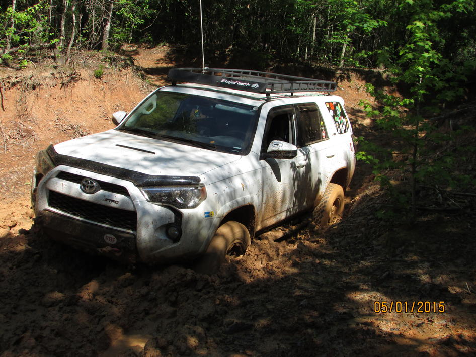

My off road option is to put it in 4WD (lock the center diff), when I begin driving off road period. Waiting until you NEED it is usually counterproductive and you've already dug in enough to be non-self-recoverable. And sometimes all the gew-gaws just aren't enough period. Hence my reason for buying a winch bumper.
To the OP... is this your first 5th gen 4Runner? The ATRAC system works a lot better than you might think to get you out of or over some pretty rough terrain.
