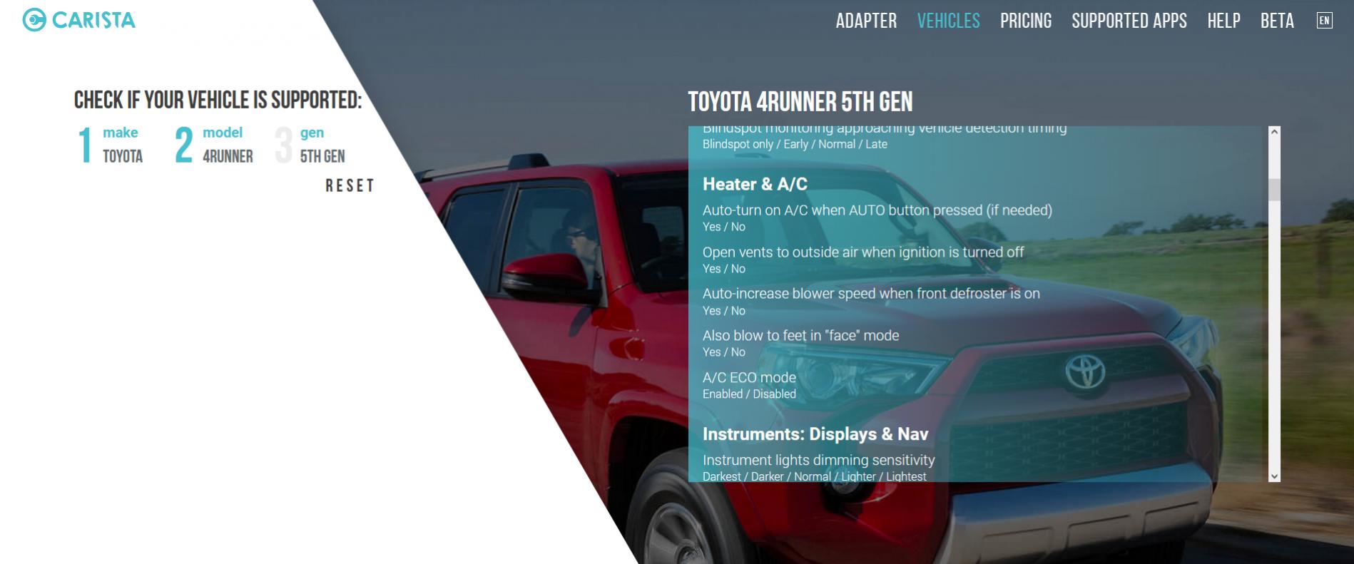

I just bought Carista and was using Customize to change a few things when I ran into a section for Heater. and A/C. In that section there was a setting called A/C Eco Mode, which was enabled. Does turning this off make the A/C/ run colder (and kill MPGs?)
My '21 RAV4 hybrid has a Eco button right on the climate control panel. The owners manual says this bout that button:
"The air conditioning is controlled with low fuel consumption prioritized such as reducing fan speed, etc. "
To me, that means with a lower fan speed it will take longer too cool down the cabin. I have no idea if the 4Runner runs the same way in A/C Eco mode.

So far, the AC seems to do it's job just fine, with Eco Mode enabled by default. We live in San Francisco, so don't use the AC every day, but it worked great on our road trip.
Seems like a dumb "feature" to limit the effectiveness of a feature, if a driver find the AC kills their gas mileage, they won't blast it on high! But for me personally, I definitely don't want my mileage to get any worse, so plan on leaving it On as the AC works well enough with it enabled.
