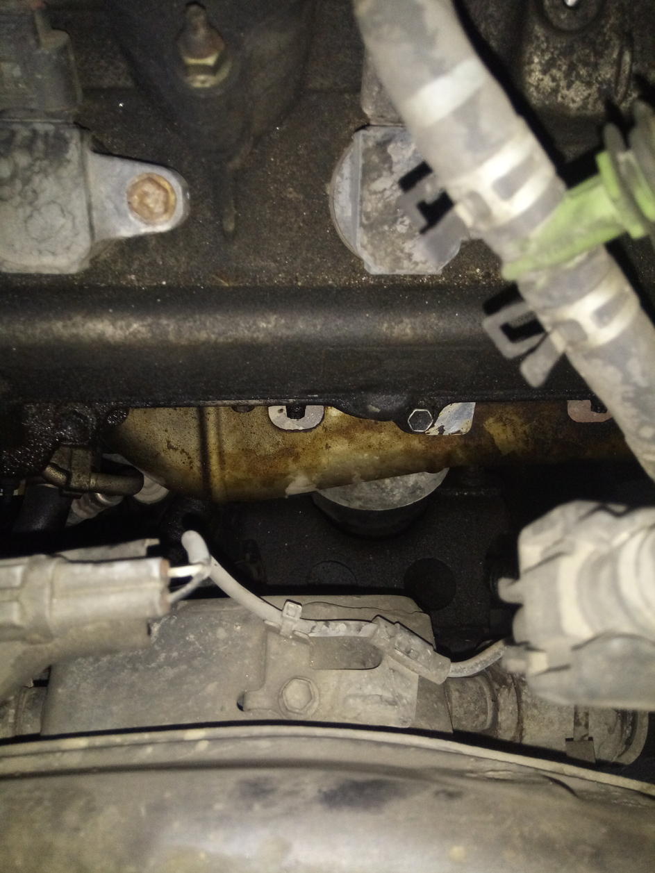

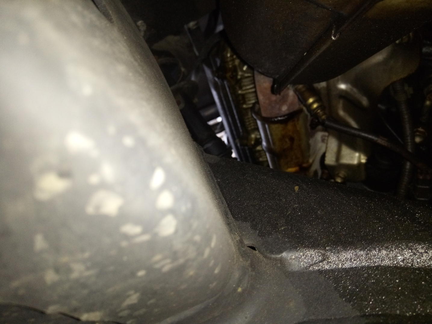

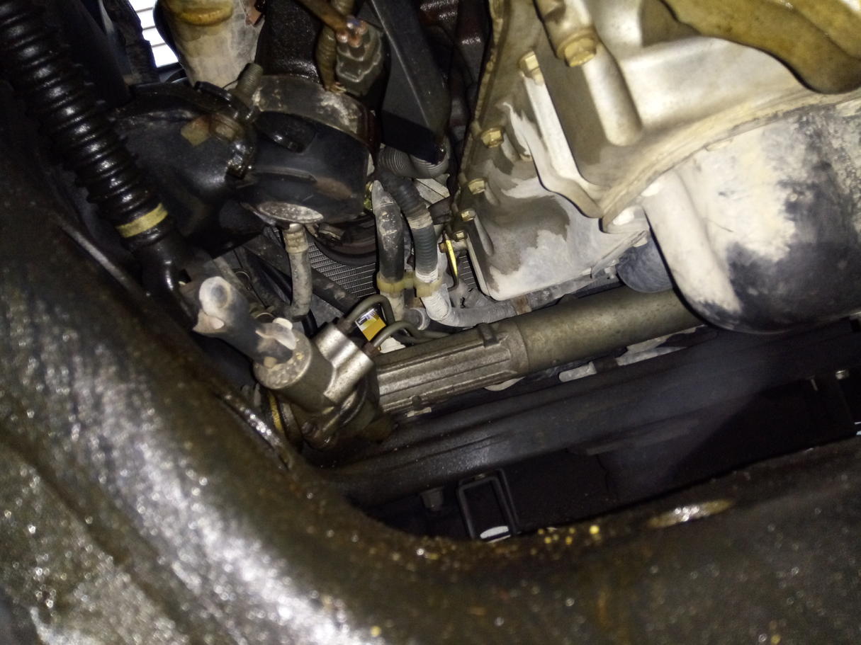

Hello Everyone, this is my first post to the forum. I am seeking the experience from this group to help me understand what is leaking from my engine. I have attached some pictures, and it is the black char/residue in the picture. I have noticed a few drips of brownish/red oil in my garage, but nothing major - maybe it all leaked out by the time I got home :). I also notice a smell from the engine area that reminds me of burnt rubber, or maybe from two things rubbing against each other. Unfortunately this is about as well as I can describe it.

Looks like your valve cover gaskets are shot.

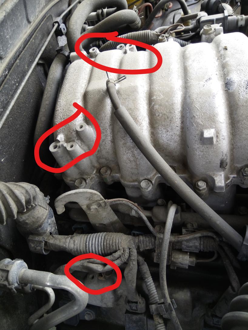

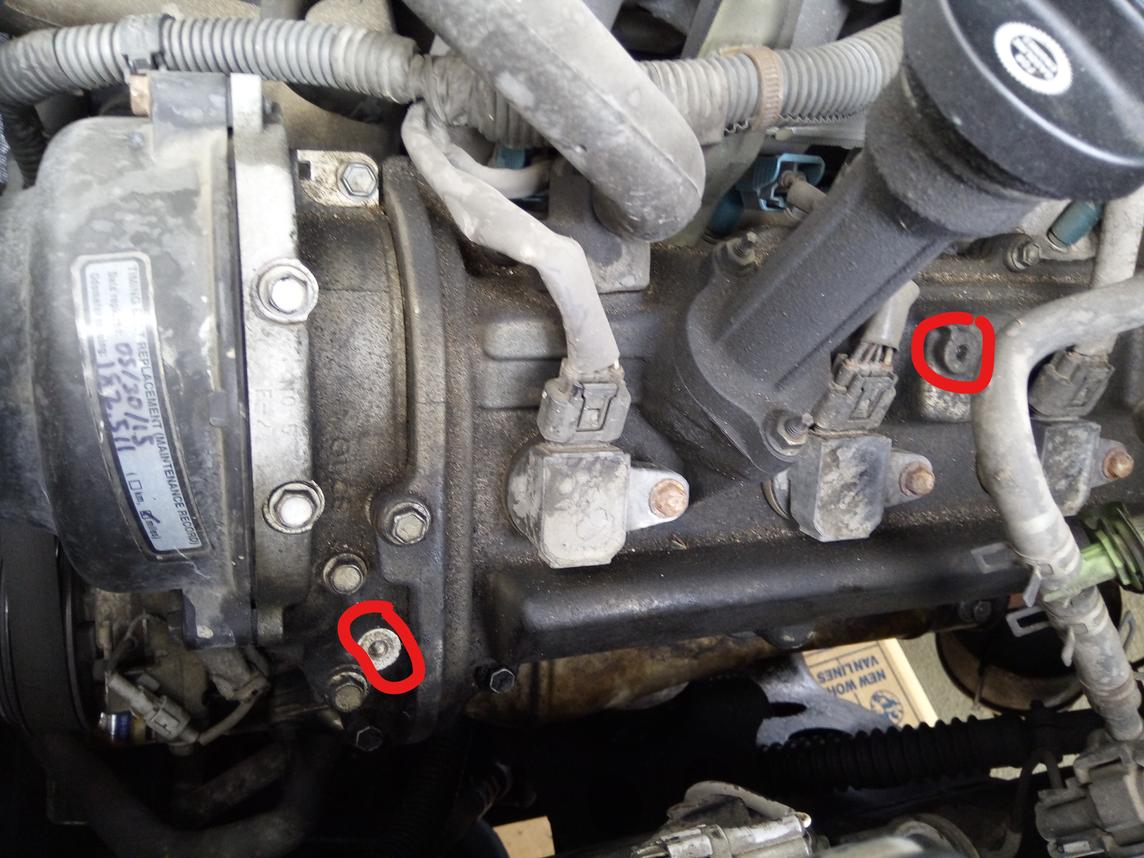

Also, I noticed some threaded holes that don't have anything threaded in them. Is this supposed to be like this? If so, what is it for? Another noob question.

Take a 10mm socket and a ratchet and try to tighten those valve cover bolts down until you can get the gaskets changed out. I had a 2003 Tundra with the 4.7L V8 and those bolts were only finger tight when I checked them. Just be sure to not over tighten.

You definitely want to get it fixed. It could turn into a fire hazard if you get too much oil and grim build up. I would do what [MENTION=70182]ASUMTNEER[/MENTION] suggested. I work at a small car dealership and we see it all the time on the 3rd and 4th gens. I have snugged the valve cover bolts down on over a dozen 4runners(very common). Yours will probably be so loose you can get at least 2 turns before you feel resistance. From there give it another 1/8 to 1/4 turn and the leak will slow. But, as [MENTION=118509]fdbyrne[/MENTION] said you want to be careful not to break anything. Don't worry about the other bolt holes nothing is missing.
