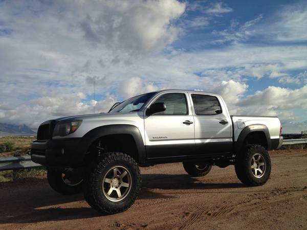

Here is my current TACO

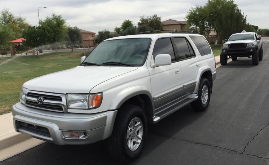

Found this beauty 1999 fully loaded
