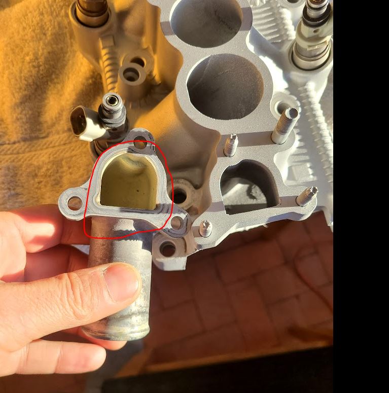

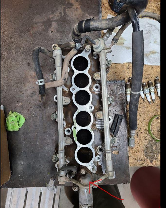

A alia176 Senior Member Jan 24, 2025 #1 I can't seem to find info on this area of the coolant system in my FSM. The upper radiator hose connects to this thing and there's a gasket that I'd like to replace before reinstalling the fuel rail. Attachments gasket.JPG 81.7 KB · Views: 241 gasket_2.jpg 115.7 KB · Views: 216
2TH4IST Member Jan 24, 2025 #2 Water outlet gasket Toyota 16341-62040 The 3 nuts get tightened to 13 ftlbs.
A alia176 Senior Member Jan 24, 2025 #3 2TH4IST said: Water outlet gasket Toyota 16341-62040 The 3 nuts get tightened to 13 ftlbs. Click to expand... awesome, thank you very much.
