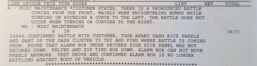

And they still are. I was at the dealership today get an annoying rattle fixed that's been driving me crazy for the last year or so. Turns out the rattle was caused by this aftermarket KARR alarm that they'd put in. Even though I didn't purchase the alarm, they left the various components in the 4Runner when I bought it. Apparently, this crap isn't worth the effort for them to remove it when one declines buying it.
Below is my description of the rattle and their fix as noted on today's repair order.
Anyway, I was walking around the lot and noticed that they still seem to be putting these into all of their vehicles in inventory.
