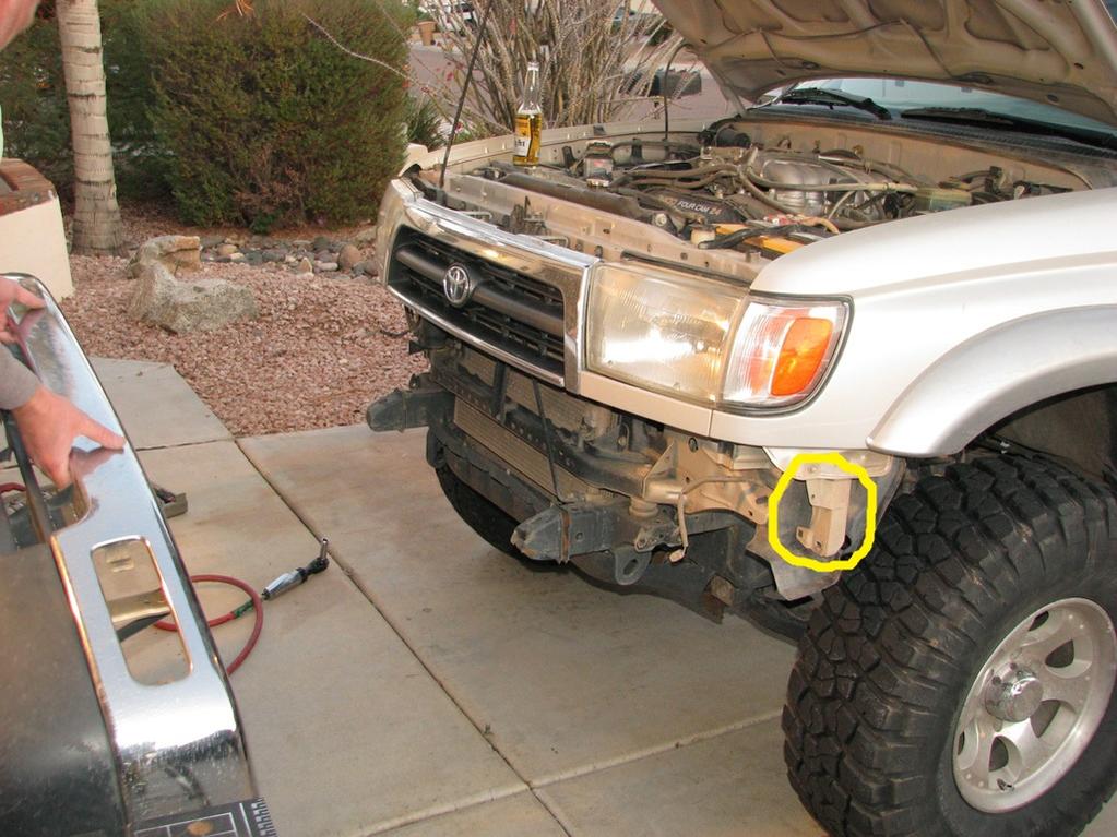

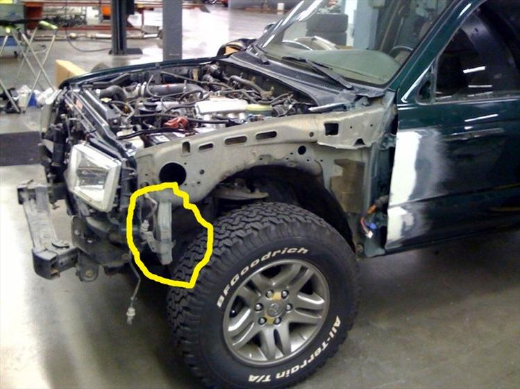

Hit some lady driving DUI and trying to replace some parts. I've found almost everything I need at a salvage yard in Mississippi but don't know how to explain to the guy what it is and mine is too mangled.

I call it "that thing that sticks down and rubs my tire at full stuff that I keep forgetting to hack off when I get back to the house but suddenly remember the next time I go wheeling". Your mileage may vary.
It's going to be spot welded or otherwise bonded to the inner fender, would be my guess. Your bumper bolts to it, but I bet you could do without it, or bend the one you've got back into shape enough to serve.
Mine wasnt welded on, just bolted underneath. And it was messed up bad enough where I think Im going to need as much support as possible

That includes shipping! And he said he would throw in that piece if I could figure out how to describe it or send him a picture of it.
I think this is the part.
53706-35060 BRACE SUB-ASSY, FENDER APRON, LH
Looks more like 53744-35010 LH, 53743-35010 RH
