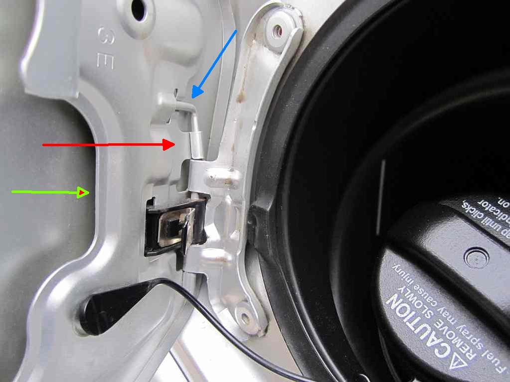

I took a pic of mine and I'll tell you what I've found so far,
You can see the bent hinge at the top (red arrow) but it's very stiff, I tried but bending it straight may damage the door or worse I may slip and damage something else.
There is very little gap between the bent hinge and the outer door skin (blue arrow) so prying it gently is out of the question as well
I did find the gap between the outer skin and the inner frame (green arrow red head) was large, by gently pinching the skin and inner frame together the problem is much better, now only full open does the door touch.
I'm reluctant to go much farther without causing door damage as that sheet metal is fairly light duty. It looks to me like the door/hinge are joined together BEFORE they rivet the frame, there is no way I can see of removing the pin without bending stuff. This looks to be a poor design overall.
