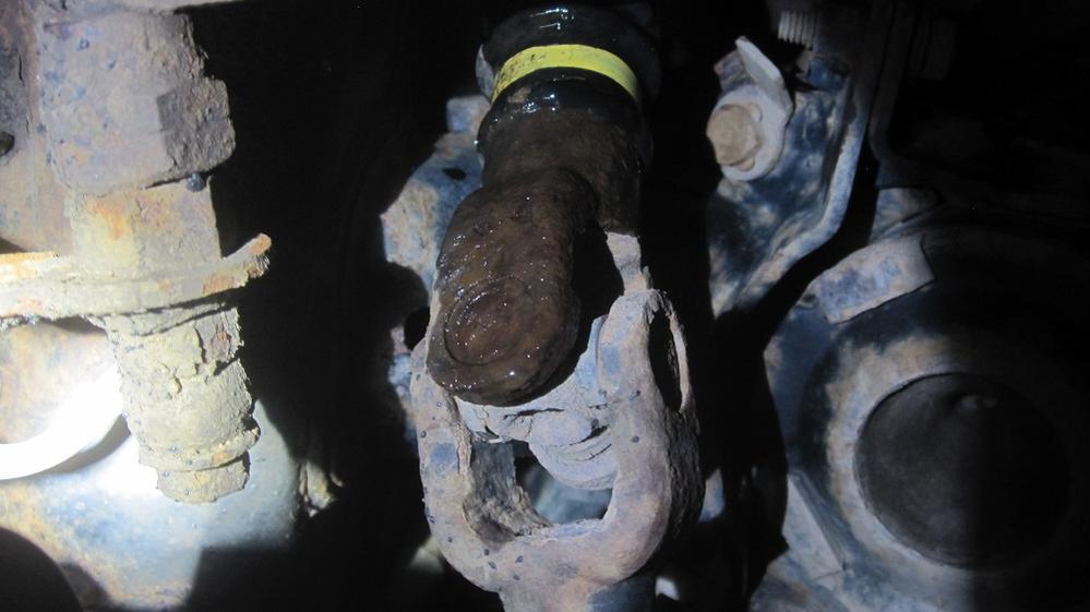

Just took a look at it and thought I would post a pic of the infamous joint (yes, I know it is past midnight here, lol). I sprayed a couple of bolts on top of the shaft, so some WD40 leaked down; thus, the "wet" on the photo. The second photo is of the top part of the shaft before spraying.

WD-40 is a good product for many applications, but when I was checking on the condition of my intermediate steering shaft u-joint I used Deep Creep by Seafoam. It almost immediately loosened up the joint, thereby pinpointing my problem. Lubrication was only a very temporary solution, as my u-joint was corroded just as bad (or worse) than yours. The Deep Creep will also help with all those rusty bolts as well, to make removal easier.
Thanks, [MENTION=26691]Bossman[/MENTION]. I have never heard about that product before. I will look it up.
I forgot to mention in the previous post that after spraying it with WD-40 and going for a ride 5 minutes later, it was working like new.
