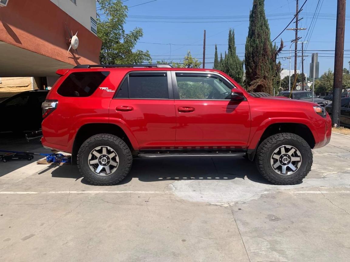

Wheels: TRD Off Road Wheels - 17x7.5 - 15+ offset (please correct me if I am wrong on this)
Tires: BFGoodrich KO2 AT 285/70R/17s
Lift: Icon Stage 2 Kit (non-adjustable UCA)
Modifications: Fender modifications, Mudflaps still on, and NO BMC

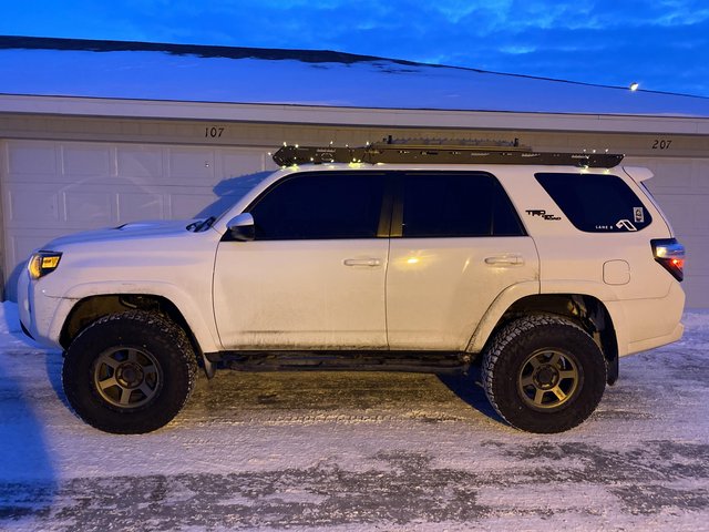

Wheels: Relations Race Wheels RRV4-V -12 offset
Tires: 275/70/17 Falken Wildpeak AT3 10 ply
Lift: Dobinson's 2.5" front 1.5" rear + Dobinson's UCAs
Modifications: none (yet). There is rubbing in full lock, although no BMC needed.
