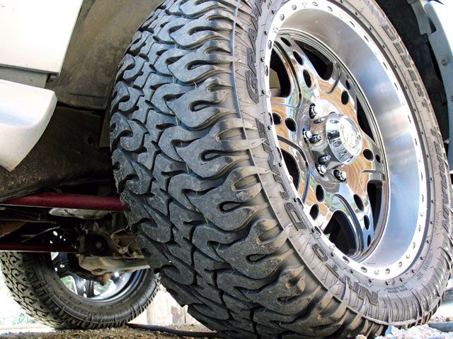

What about
Nitto Dune Grappler DT
265/50R-20 111T XL B
Something like this is what I would like for my t4r...my rims are going to be more offroad looking tho',....but this is the size of rims and tires...
This truck has the Nitto Dune Grapplers 265/50/20 but I am not digging those tires too much...really dont' like the flame tread design . But this is the main idea .
