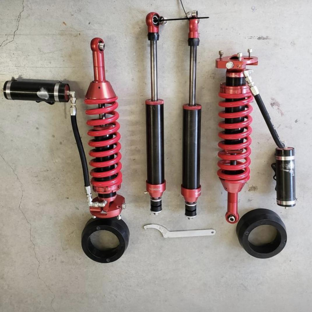

Does anyone know what kit this is? Is it any good?
"good" is a subjective term when it comes to suspension.
I have no clue who makes them but here's what I can say:
It looks like the kit you have shown is height adjustable. If the springs are typical 2.5" springs, then you can swap in whatever spring rate you'd like.
I see spacers intended for the rear springs - I'd avoid those and get taller springs if you want a lift.
In regards to the shock themselves, I don't know how they're valved which means it could be something custom and can't tell just from the exterior
Since they use metal ball joints for the mounts rather than the factory rubber donuts, it will ride very rough -- you won't have the cushion that the rubber provides. My guess if they are for serious racing applications where they don't care about ride.
Those rear shocks, at the bottom in the photo on the red cap, should say the brand name right on there. I'd have guessed Toytec too
I would have said Walker Evans - I think the more traditionally are red and silver but image they could be bought in black.

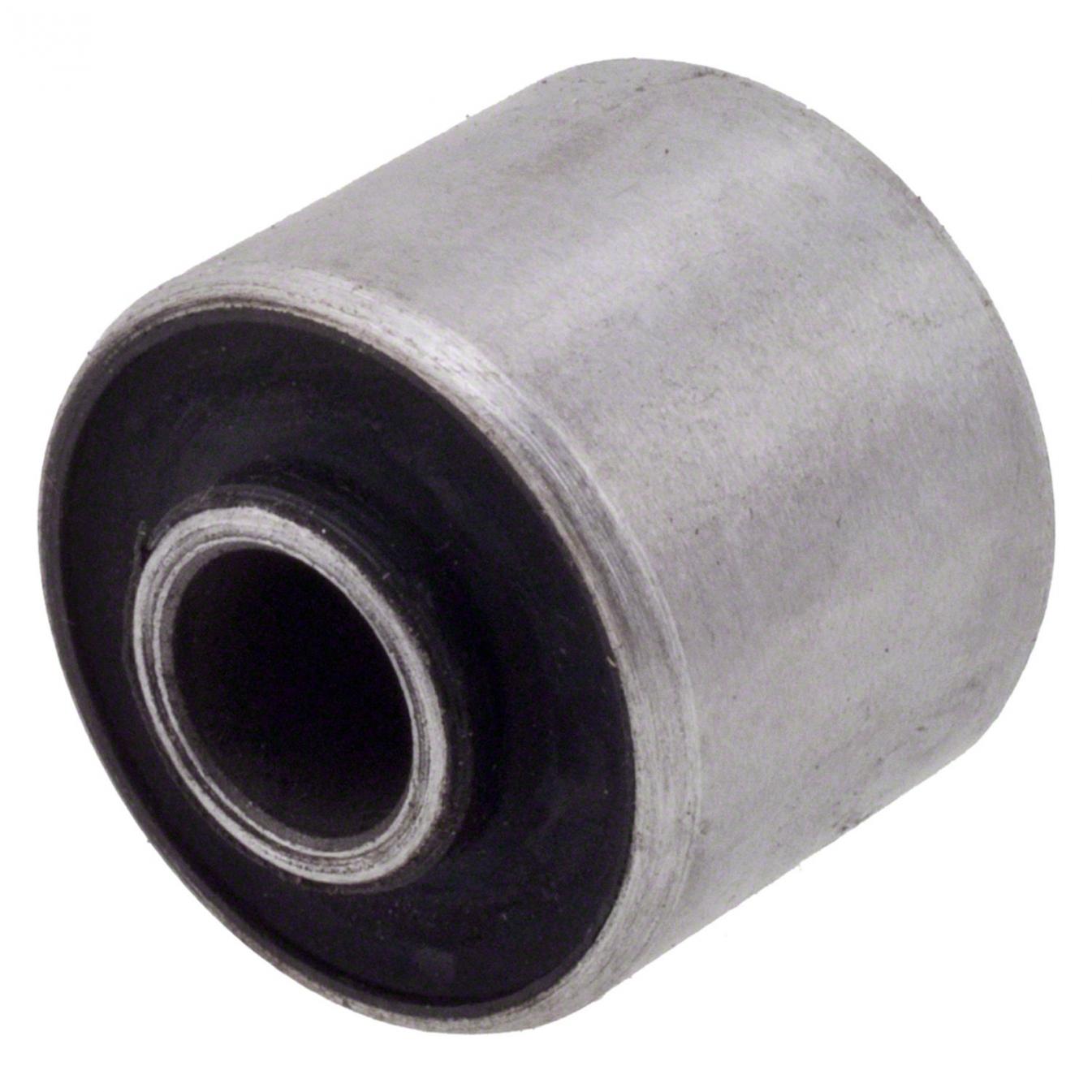

I'm not referring to the UCA bushing. I'm referring to the front lower shock mount where it connects to the LCA. In some manufacturers shocks there is a rubber or polyurethane bushing in others (Radflo as a for instance and other race style shocks.) there is not. It does not directly apply to ride quality as it's being presented in the Accutune link you provided. It simply adds a slightly stiffer thunk for lack of a better description on low speed bumps as I described.
I attached a couple images to illustrate. Forgive that they're kind of generic and the sizing

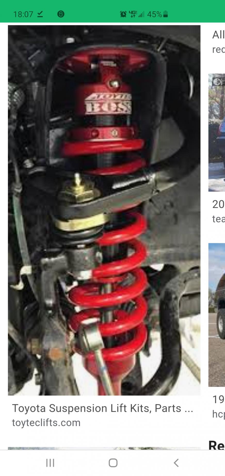

It sure likes like it says Toytec and the font matches. I'd send them an email with the photo and ask specifically which one it is.
