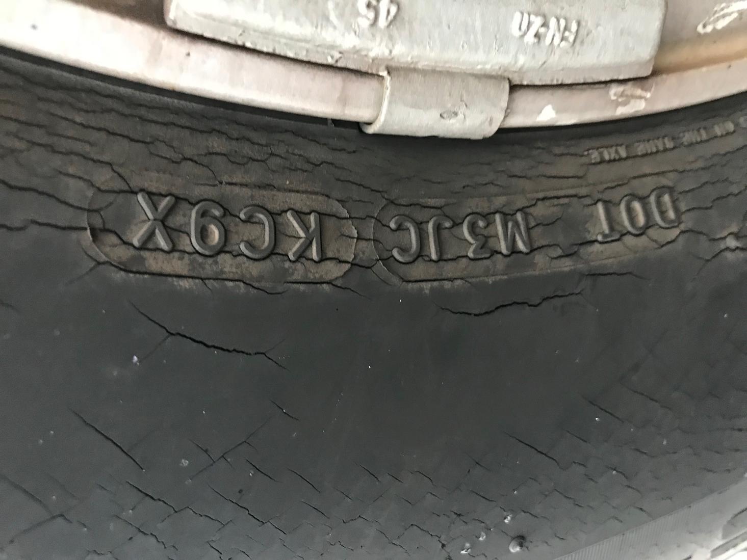

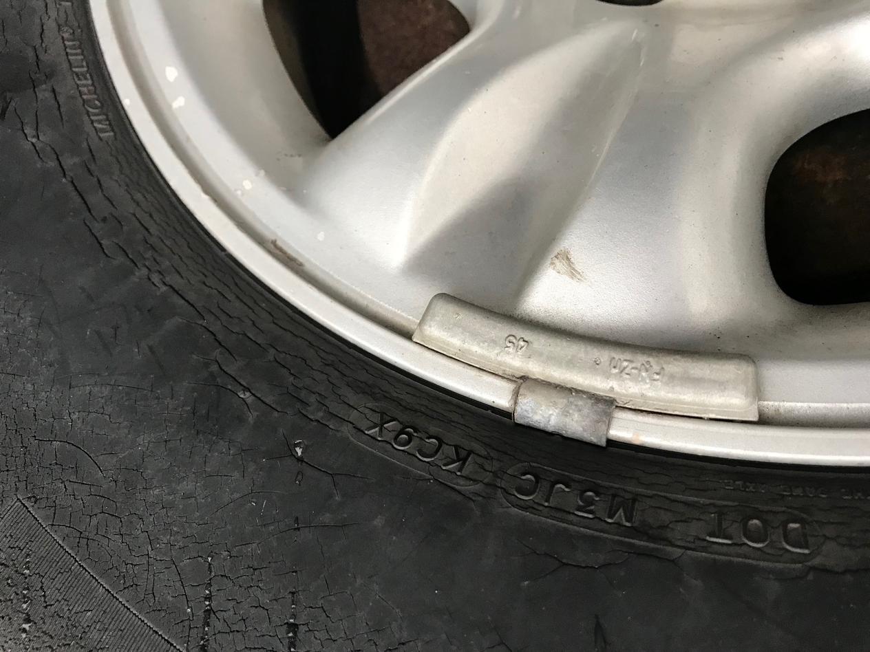

My Michelins LTX MS/2 developed sidewall cracks to that point that it's unsafe to ride them, so I'm thinking replacing stock size tires w/ one size larger 265/75/16, but not sure if wells will clear. My rear is soggy a little, about 1/2"-3/4" and while I'll be doing that I want to level and raise the truck just a bit. What is the best leveling solution for it?

Isn't that a recent tire? Michelin is really dropping in quality nowadays. The original LTX M/S was just a far better product. I have a spare from 2005 that still looks great. Made in Japan too. I don't think it's economically feasible nowadays.
My thought exactly. The thread is still good for another 20-30k easy, but the sidewalls all cracked up to the point that I'm second guessing any planned trips over 50 mi long. Especially thru the mountains. So I'm thinking spending less on tires, used them up and change them once in 5 years vs spending more and trash them without even hitting their warranty mileage.
That's insane brother. I've seen older China tires that looked better. I would actually contact Michelin and complain. You've got nothing to lose from just asking. Nothing quite matches the quietness and ride quality of these, but this is a deal breaker.

I did chat with Michelin. Problem is I don't have original invoice, email or whatever came with the tires years ago and can't prove the date of purchase, but they are sending me to one of their local dealers to inspect the tires and call them back with the results. They opened a case for me. Their warranty btw 70K or 6 years from date of purchase. I def don't have 70K but might be close to 6 years, so...
Paid with a CC? Might have the transaction info. They're charging too much for these tires to be doing that.
Yeah CC, but again, that card number was replaced few times since then due to fraudulent charges, and I did try to look for it, but the online records are long gone.
So I guess I'm at the mercy of Michelin and their local dealer. It would be nice if they pro-rate them at least a little bit. But I don't have much hope, If they don't - no more expensive Michelin for me. Will research as much as I can and buy mid range tires with good reviews and up to 50K warranty on thread wear.
