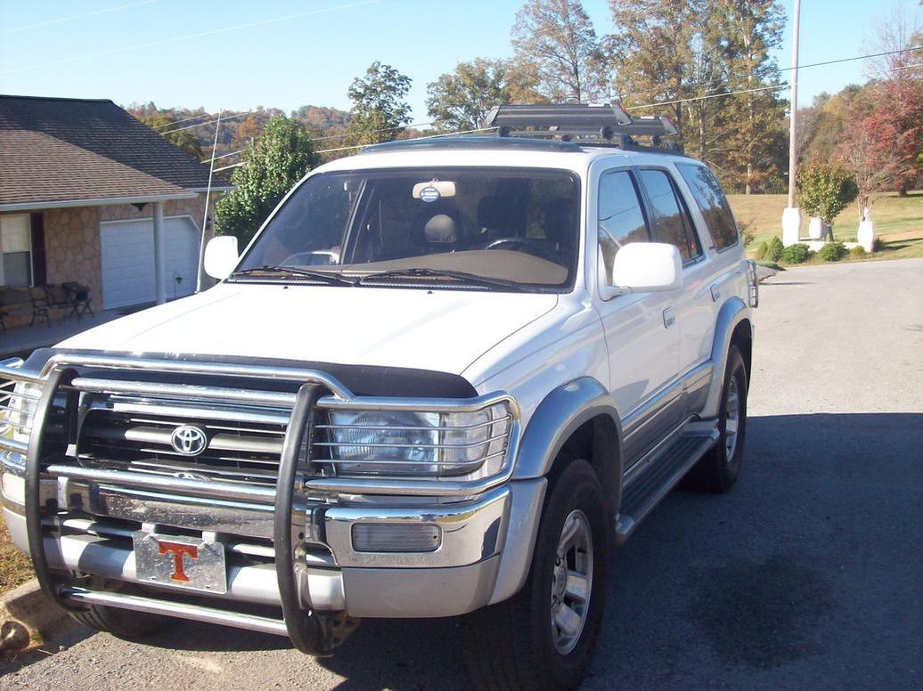

I dont really have many mods on my 96 right now but i do have a manik brush guard i would assume the brush guard weighs more than 100lbs. and im trying to decide if i want to go with an 881 coil or an 883 coil. i will be getting it from toytech most likely unless you guys have a better idea just seems like through the research that toytech is the best for customer service and price and product. whats your opinion?

I seriously doubt that brush guard weighs 100 lbs. I think the arbs weigh around that. I would go with the lightest ome coil.

depends on your intentions but i defiantly wouldn't count your brush guard as being extra weight and compensate for that with upgraded coils.
alright... so basically i do light off roading nothing major just through some creeks and some 4 wheeler trails... what kind of lift would you recommend? im wanting around a 2.5 to 3" lift
Yeah I wouldn't even take that brushguard into consideration, it's probably 30 lbs. I agree with izzard that the 882s (and 883s) are way to harsh without a lot of extra weight. Mine rode stiff for almost a year, but they've finally broken in and I wouldn't trade them for anything now (and I have an ARB which weighs a lot more than that brushguard. I would go with 881s (for ~2") and add a top plate spacers if you want 3". If a smooth ride is what you're after, then the TRD Tundra coils will be the best choice IMO (also like izzard recommended).
