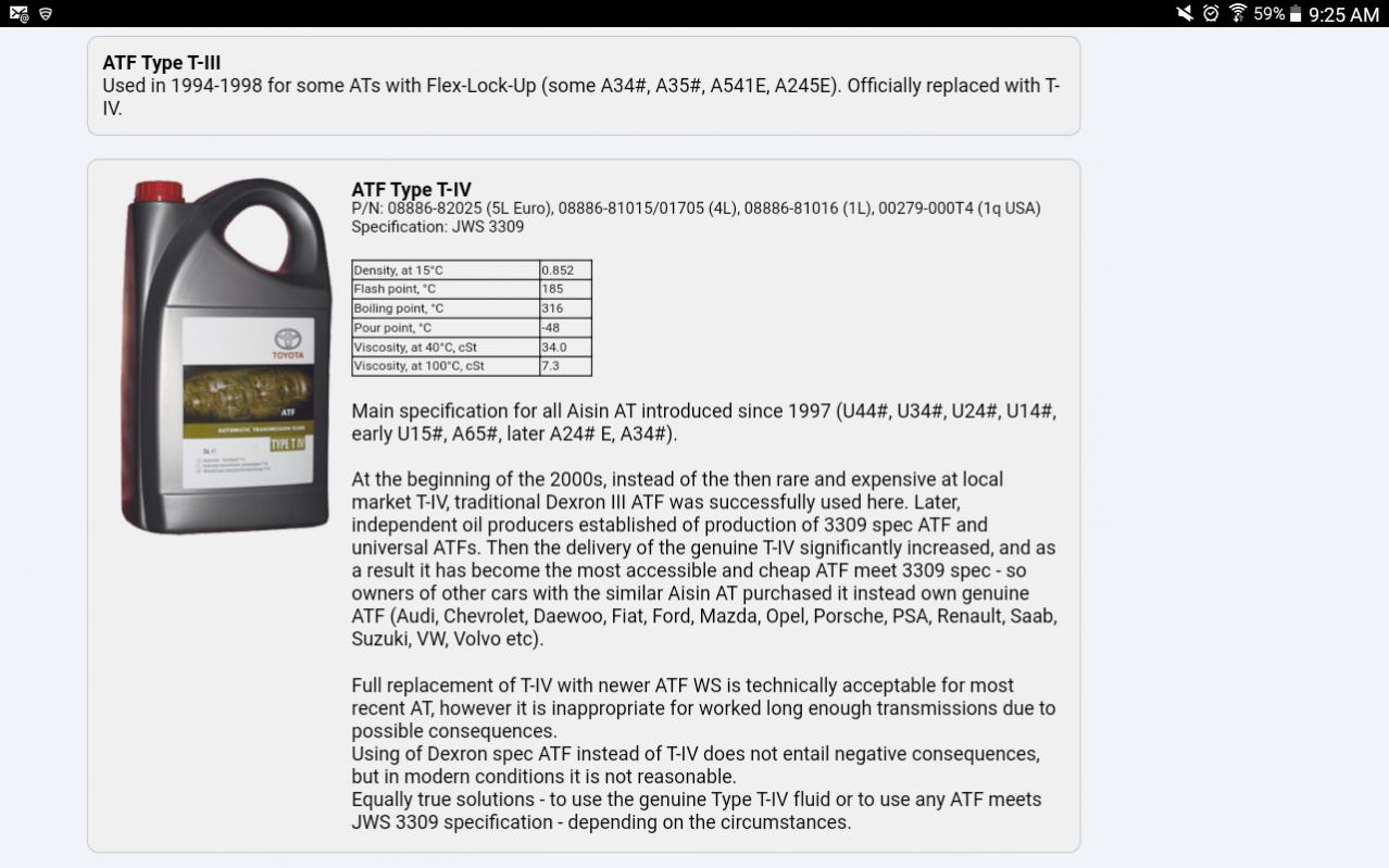

Thanks. I replaced the fluid with t-iv last year and Have not had any issues. But I vé have bought 14 quarts of t-iii fluid and will replace it when I get some time because it just makes me feel better, since I have over 400k miles on my original transmission. Also spoke to toyota service manager who said they use the bulk oil from toyota that meets wjs 3309 requirements.
Here are the 3 Technical Bulletins on the Only using Dexron II or II in our transmissions. I have all the TB for our 3 gens and this is the only thing I have seen listed 3 times. Everything else is only listed once.

Castrol I Believe is the MFG of Toyota Transmission fluid. So the Castrol Dexron equivalent should be as close as we can get to Toyota Fluid without using Toyota Transmission fluid.
The Dexron III fluid equivalents are fine in these transmissions. So pick one that works the best for you. :-)

Thanks for the tsb. I had a hell of a time finding t-iii but the t-iv was readily available. I will go back to t-iii but because I replaced all of the fluid I think it helped since I didn't mix it and ran 10 quarts through the system and then topped it off.
No problem. Yes I have seen people stating its extremely hard to get a hold of anymore. I saw they want $12 or $15 or more a quart for it too. That's crazy. Unfortunately it's supposedly not good to mix transmission fluids.

... bulk oil from toyota that meets wjs 3309 requirements.

Notice the first two sentences of the 3rd paragraph, where it talks about the new Toyota WS transmission fluid.

Yeah I noticed that as well seems like English is not his mother tongue. I drain my atf pan with every oil change at around 7k miles so I go through it a lot. Just bit the bullet and bought it but haven't used it yet. The Trans is running strong with t-iv and have had no issues hence i thought i hit the jackpot. The conundrum is the worry, "Just when I think I am out they pull me back in".

I am sorry for the TB news [MENTION=50279]spartacus[/MENTION]. I didn't mean to cause you anymore work. :(
Almost like 95% of all Toyota transmissions are T4 compatible. Except our 3rd gen 4runners are not. I really wanted them documented for all the users. So if someone reading the thread they will know that it's not Recommend for the 3rd gens. :)

No need to be sorry. I appreciate the tsb info. It helps me make the right decision. Thanks.
