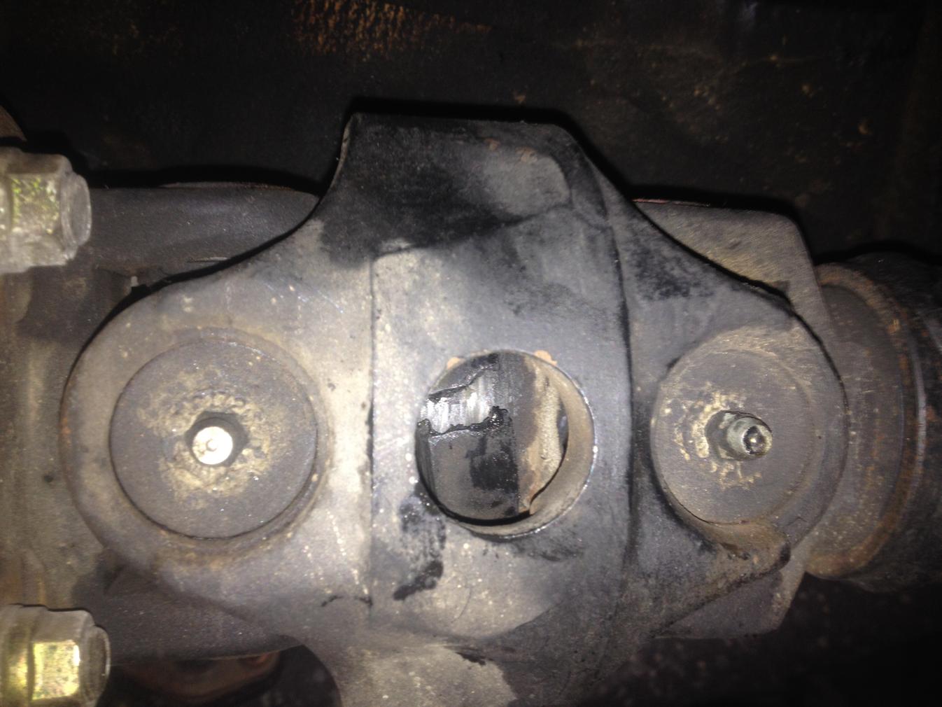

Y yota-runner New member Oct 19, 2013 #1 My 96 4wd rattles when I accelerate, I got under it and found this. Is something missing there? Do I need new u-joint? New driveshaft? Attachments image.jpg 124.8 KB · Views: 249
0 02SE Senior Member Oct 19, 2013 #2 That's your Double-cardan joint, and it appears to be broken. I'd find a competent driveline shop in your area, and have it repaired. If there aren't any good driveline shops in your area, I'd contact this place: Tom Wood's Custom Drive Shafts - Tom Woods Custom Drive Shafts Custom Driveshafts Specialist I had several driveshafts built by Tom Wood, years ago when he was an just employee at another driveline shop. He built Excellent driveshafts back then. I assume he still does with his own business.
