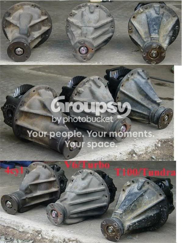

The only difference between the 4cyl and the V6 is 2 pinion gears vs 4 pinion gears. The pinion shaft and pinion bearing are also bigger in the V6. It's a direct swap regardless. Both are 8" you just might need to specify engine size when ordering lockers.
3rds.jpg~original
3rds.jpg~original
