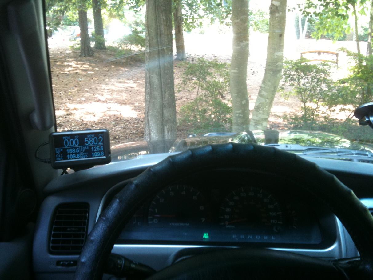

I am rather pleased with the Ultra Gauge I have had for about 4 days so far.
Ordered it when they were out of stock back on July 5th and they gave an extra $5 off so it was $63.95.
You get $9 rebate after filling out some totally draconian rebate form that was borderline ridiculous but still you get $9 back. So was only $55 plus the shipping which was $8.26 so total cost was $63.26 after rebate.
I have not had any "codes" yet so I assume it will work just fine for that.
But it is very helpful to check your gas mileage, engine temp and many other things plus codes the second they happen.
Fits nicely and very easily in the left hand corner of windshield with its supplied bracket, took about 2-3 minutes to install, totally out of the way and easy to read while driving.
Hard to beat it for under $65

yeah i liked that one but no metric!
I moved here from Canada in 1994 and I still can't figure out why Americans don't use the metric system yet! Damn stubborn Americans!! (I have dual citizenship, so I tend to go with the argument which benefits me at that time. Maybe next week I will make fun of the Looney)
