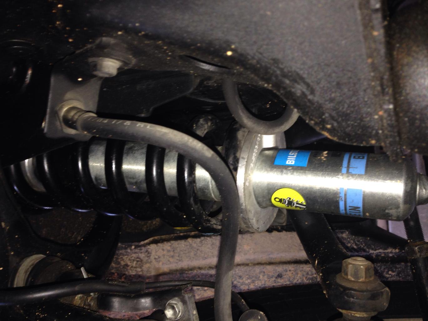

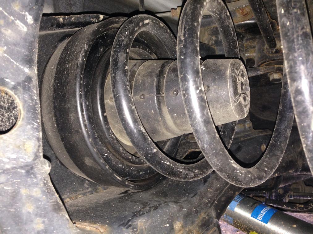

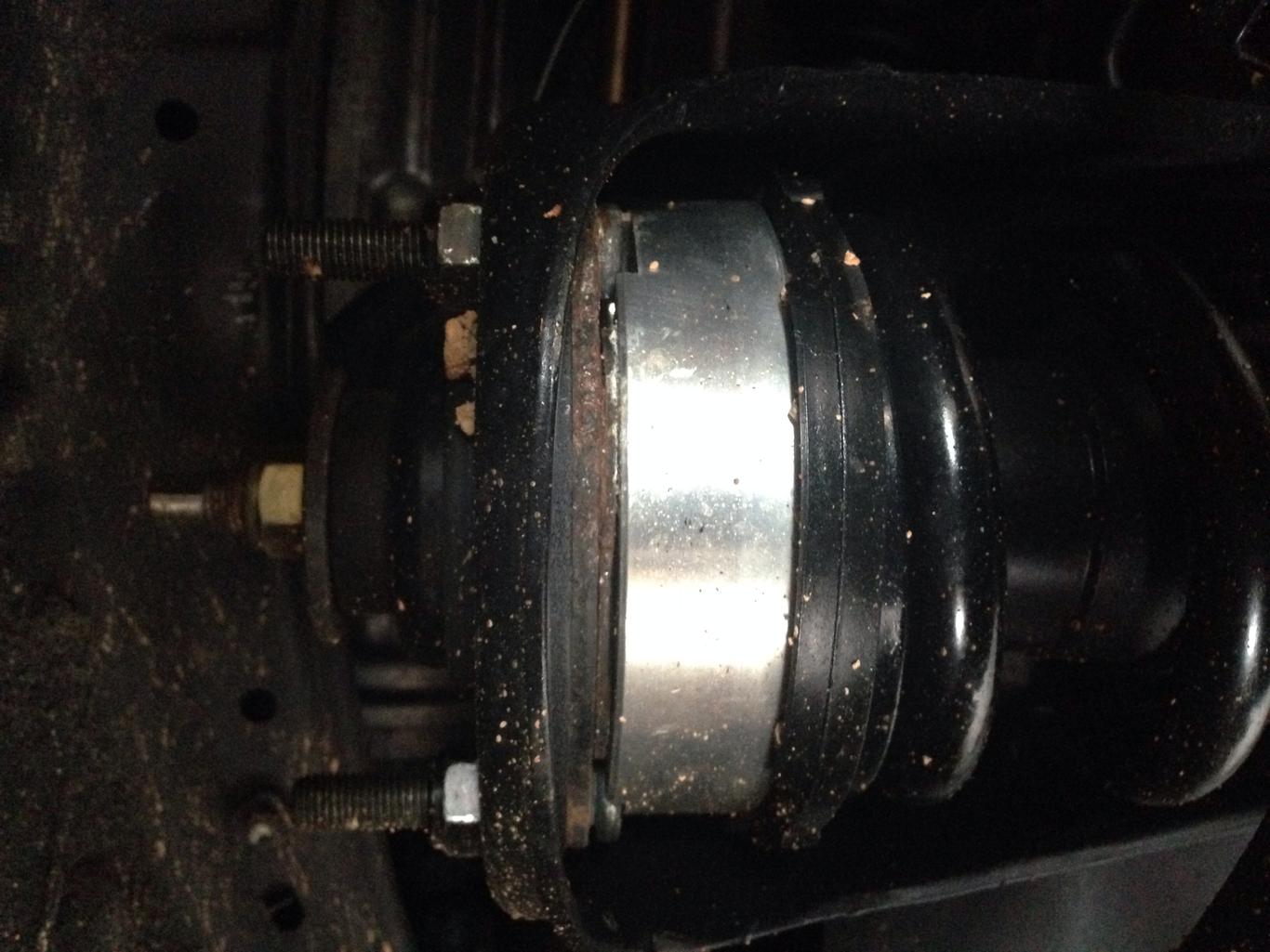

I know there are billies in all four corners but is this a spacer on top of the shock or is it a part of the shock? Also I am assuming this is a spacer in the rear?
Sorry for the sideways pics. For some reason it does that when I use my phone

yup looks like a rear spacer too
Weirdm the billy in front looks like its set at 0" of lift and they used a preload spacer instead. Not the best way to do it
Do I need to get rid of the spacers? Can I crank up the billies and still fit a 33?
dont do that you'll overextend and ruin the shock
I'd ditch the spacer and set the front at 2.5 and maybe add a 1/4" top plate spacer good for 1/2" of lift, run a 3" lift, do a bit of trimming and throw some 285s on it
also, rear looks like 1.5" daystar spacers
