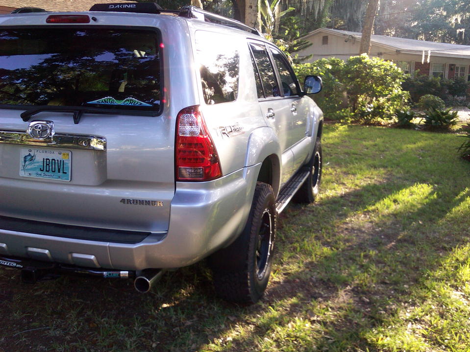

so i was wanting to do rims and tires and have a lil wheel sticking out past fender but not alot...what leveling kit would you use for it...it has 80k so im ready to replace the factory shocks and struts...and then what size tires could i fit under it with it being level...thanks i appreciate any help as im new to the 4 runners
17x8 wheels w/ 4.5in Backspacing and zero offset, brought the tires just outside the edges of the rear wheel wells, and just about even in the front on a 2007 runner.....they have bigger fenders than the 2005 and earlier models. My 2007s flare out noticeably more than my 2005 does.....heres a shot from the rear showing where the wheels sit.

looks nice id probly go more of an 18 or 20 in. wheel...did you do a leveling kit or no...i was looking at the cornfed kit but not sure if i want to do that or just level it...its my dd so dont want to kill my mpg...i feel like it is bad enough....but i was ust to a 35 gallon tank in my diesel truck and this one is smaller so it doesnt seem like i get any mpg at all...more pics of others would be nice...thanks
18 or 20 inch wheels w/ the same offset/BS will still appear about the same for sticking out.
I've got a full suspension lift on there, coilovers w/ new shocks and springs in the rear......I decided against the lift spacers because I wanted an improved ride, plus the better offroad ability.

how much did the kit you put on urs run...i just want it to be level...
Suspension kits run anywhere from 700-1300++. My Toytec cost me 1100 shipped and I did all the labor myself, saving me hundreds of dollars in labor.
If you want just a leveling kit, they can be had for super cheap...probably 100 bucks give or take. I actually might level my 2005 Limited and put on 265/70/17s just to give it a better appearance and stance. Thats a cheap upgrade that will enhance the appearance and not cost several thousand dollars like my lift/tire/wheel setup.
Watch the classified section for leveling kits or post a WTB and I bet someone will have what you are after. If not the daystar and cornfed are both popular choices on the forum.
