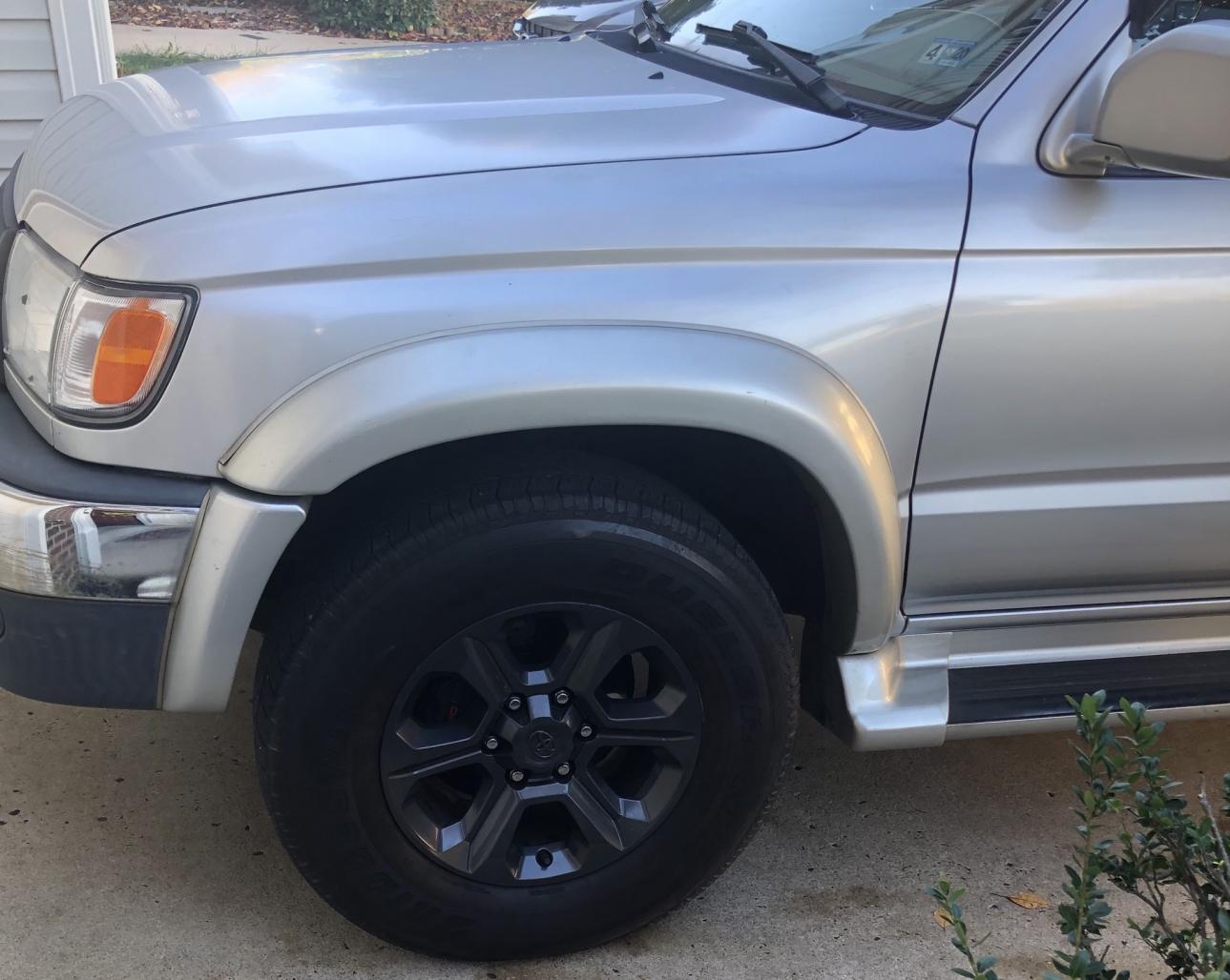

I want to replace my front shocks on my 2001 SR5 . It’s stock no lift . I have the 5th gen 17 inch rims . I just need help to find the best shocks for daily driving. Any suggestions
Thank you in advance

It's 100% opinion and personal preference.
Most people agree that the best on-road ride is OEM, but it's not the cheapest.
The majority seem to have Bilsteins 5100's (should say that those majorities are for this forum only).
I opted for the Bil 6112/5160 combo and have no complaints (but I was looking for a Little more height and wanted something that'd handle washboards better).
If you're on a budget, go for the KYB gas-a-just. If you have an unlimited budget then put on some King or Icon coil-overs.
blue and yellow Bilstein 4600's, if keeping stock height. 5100's if lifting a bit. Just about to put a set of 4600's on my 2001 with 5th gen springs all 4 corners
If the stock shocks are blown, anything new is going to be better!
I did NAPA shocks on a completely stock Tacoma and was very pleased at the ride on it. I had a crazy deal at the time with a company discount + sale, and walked out with 4 shocks for 90...

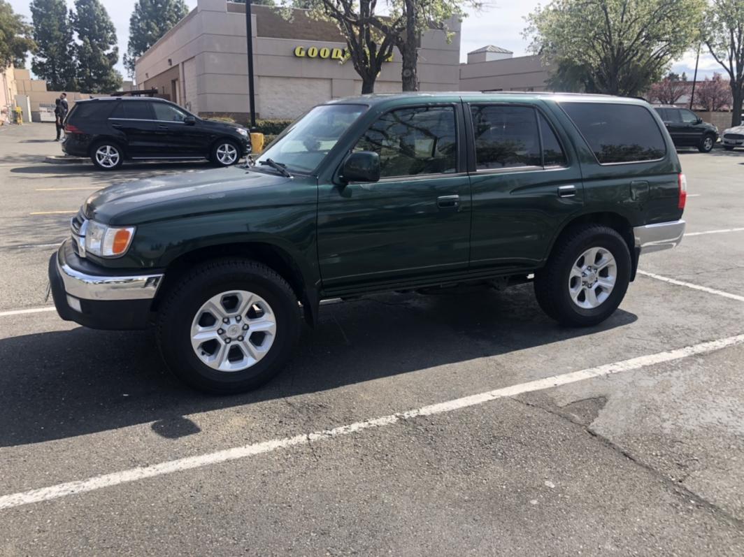

Definitely following this thread. OP you and i have pretty much identical set ups, I also have a 2001 SR5 with 5th gen wheels except they’re still silver for now. My shocks and possibly struts are on their way out. Anyway i can tell the difference without taking it to a shop?

If you are never going to lift and want a comfortable ride, you have at least three good choices: OEM, KYB and Bilstein 4600. The Bilsteins will be a *bit* stiffer than OEM/KYB, but are still very comfortable. Avoid the normal parts store shocks - they offer either a crappy ride, poor longevity or both.
Also, you have shocks on all 4 corners - the fronts are often mislabeled as struts though... (they are coilover shocks, not struts)
