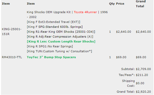

I ordered them thru Filthy Motorsports. Their service is A+++ . The process is is not just "click and buy" with them. We talked on the phone about my rig's setup, weight, my habits, the load out, and any future plants to make sure I get the best shocks possible.

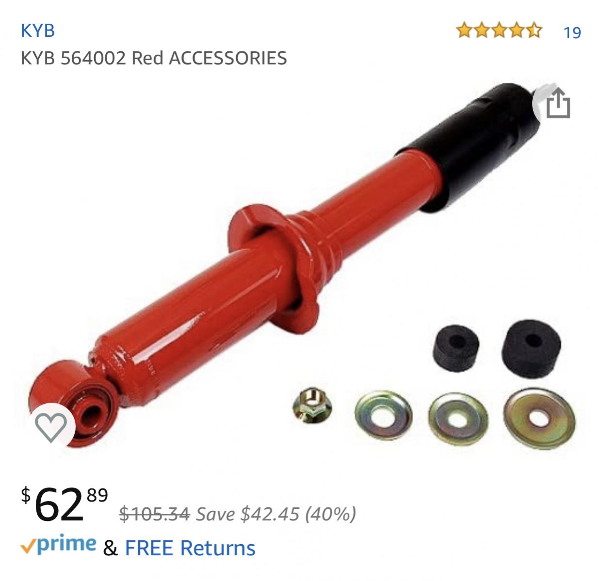

Amazon has a good deal on kyb momos
For anyone that wants to buy new shocks
It’s been mentioned above a couple of times. If you don’t want to go the Billy route, the KYBs have been recommend. They are 1/2 the price of the Billies and are reported to be closer to a stock ride. There are members here who actually are using them.
