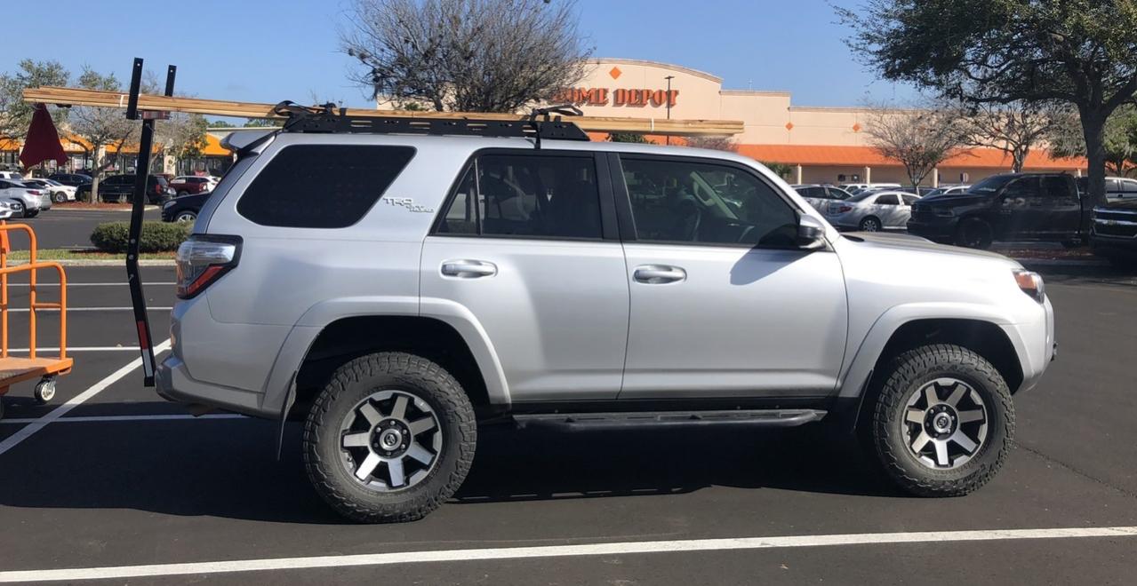

In order to use ratchet straps properly with the pro rack, you also need some soft loops for the hook ends to grab.
Rhino makes some solid ones.

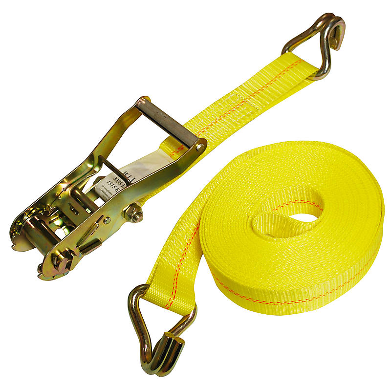

As a general rule - I almost always use typical 2" heavy duty ratchet straps. Most 1" width straps are garbage. I'm sure there are some good ones, but most are crap. The ratchet mechanisms are usually just not very good and dont' last a long time.
However - the standard hook end on a common 2" ratchet strap like this is too large to physically fit under the OEM cross bar.
So you need to find straps with ends that look like this if you want them to be easy to use on the OEM rack.

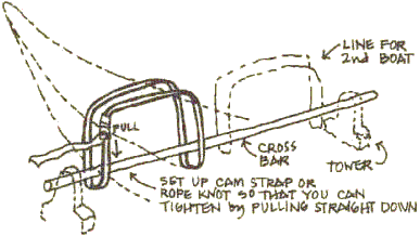

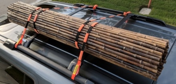

The biggest mistake people frequently make tying down stuff is to wrap the strap around the object in a loop. Don't do that. You go over the top and use the strap to hold the object down against the rack and friction between the object and the rack is what keeps it in place.
NO:
Yes:

Pretty safe bet that your "no-no" example is actually the best way to attach a bunch of bamboo sticks to a roof rack.
It's wrong for a variety of reasons. Wrapping the strap around the bundle will result in any movement of the bundle leading to a lower strap tension and the potential for the sticks to fall out. It's also not centered - so as the roll moves to the middle of the rack - it will get looser. The safe way to tie something like that down would be to bundle the sticks with one set of straps and then attach the secured bundle to the roof rack correctly.
The other alternative would be something like this that would naturally compress the bundle in away that both secures it properly to the roof rack and compresses the bundle to its self so that individual sticks won't come out (not my drawing, but the strap routing shows how it should be done):

I'm sure there are some really good quality 1" straps. I've just never found them at a reasonable price. A typical all metal ratchet with a 30' 2" strap is around $15 and lasts for - basically forever. I've yet to find a decent 1" strap with a high quality ratchet mechanism that's similar in cost.
There's nothing you could ever haul on the roof given the 200lb weight limit that would justify a 2" strap for strength. It's mostly just the availability of quality ratchet mechanisms and strap materials on 1" size that is the deal breaker. I have half a dozen 1" ratchet straps around. They all end up not working very well after a few years.
