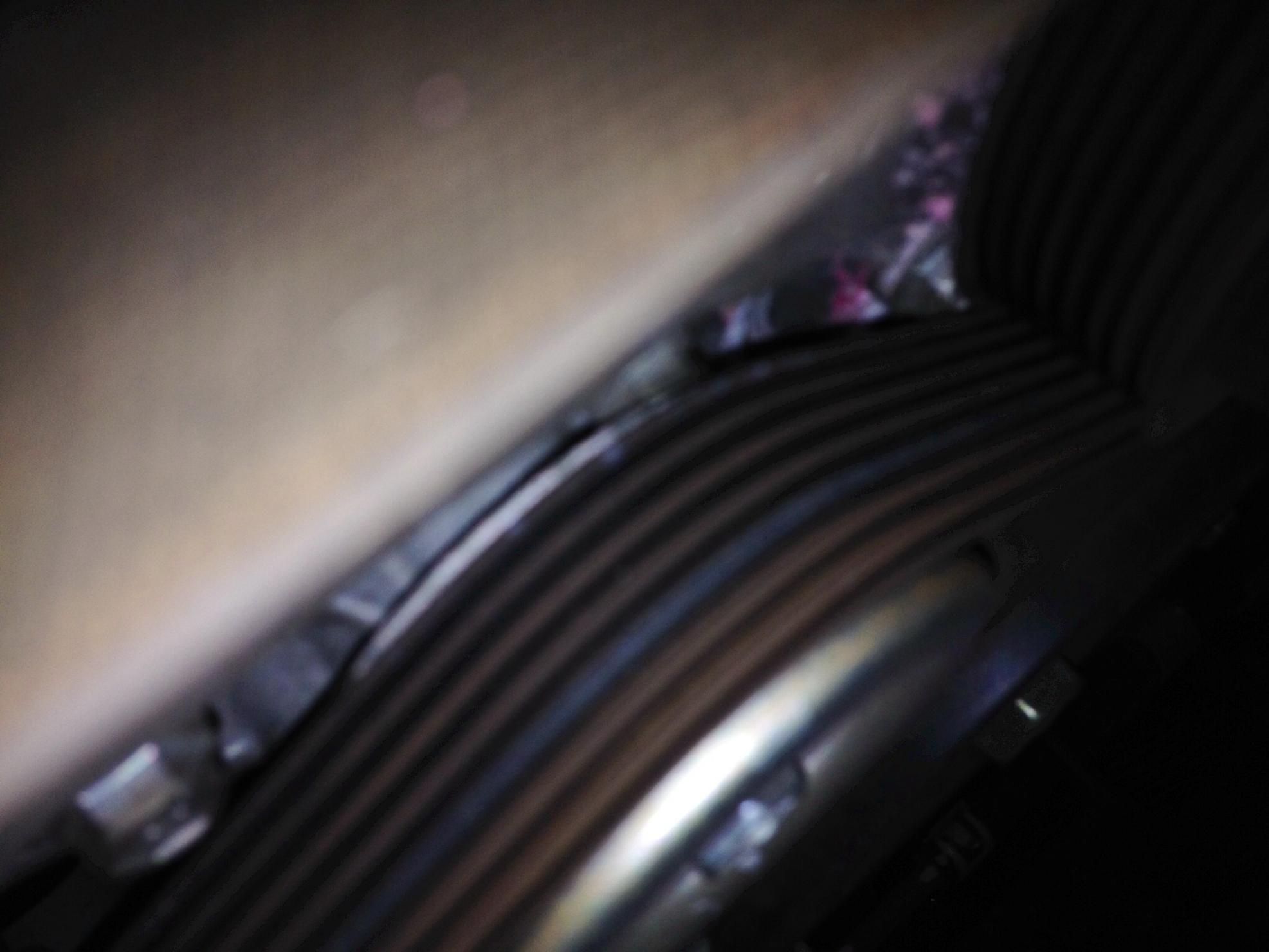

Here is the pic. It does look like leaking!!

squeaking sound is one symptom of water pump issue or fanbelt issue too. As for your photo- it has what looks like a belt which i assume is in front of the water pump, wheres the leak ?? the pinkish color ?
That's what mine looks like and I call that "leaking" or "weaping" ... whatever the case, it's not designed to do that for extended periods of time...

I'm trying to find a TSB I seen a while back pertaining to these seeping water pumps. It basically said that they are supposed to weep a little now and then. That is how it rids itself of buildup around the seal. It also instructed the techs to only replace if excessively leaking or bearing failure. Anyway, my 4runner's WP seeps just a little from time to time. Since '08 I've added maybe 1-2 quarts of antifreeze.
