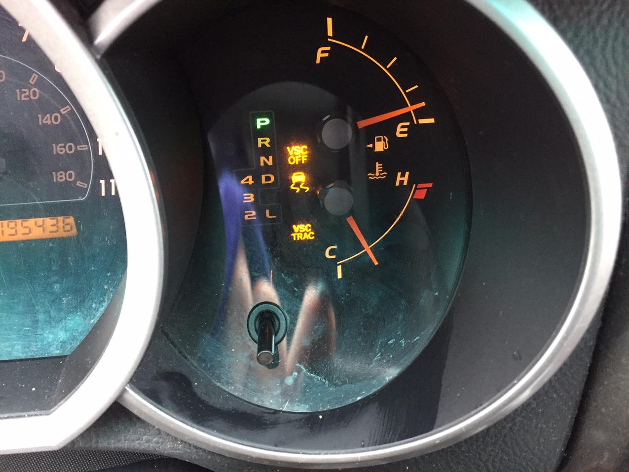

I am looking at a 2007 4runner V8 4x4 with a 195,000 miles on it. The carfax has good history (for oil changes and brakes but nothing else). Its been in the same family since new.
Recent Maintenance: Calipers, Rotors, Wheel Bearings, Exhaust Manifold all with paper work. However the abs and traction control lights are on, the seller mentioned this occurred after the manifold was changed because "the shop reused the sensor" (o2?). IF it is an o2 sensor is this a relatively easy DYI job? Or what sensor would cause this?

Is the check engine light on as well, or just the abs/trac lights? If it's just the abs/trac, it could be in need of a zero point cal, which is an easy DIY job.
If the CEL is on as well, it could be any one of a large number of things. In that case, I'd have someone check for diag codes, or do it yourself. An OBDII code reader is about $20 from Amazon - well worth the money if you own or will own a car > 5 years old. It's so much better to let the vehicle tell you what's wrong than to guess based on hearsay from an owner or anonymous mechanic.
I was able to get the seller to send a picture of the dash lights, no CEL.
