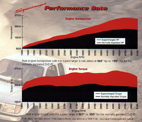

What are you smoking? Pass it to dee lef han' side!
TRD claims HP increase from 183 to 265. The torque is improved from 220 to 267.
Maximum horsepower gain: 75hp at 5200 RPM
Maximum torque gain: 77lb.ft. at 5200 RPM
Peak horsepower increase: 64hp (187hp to 251hp)
Peak torque increase: 50lb.ft. (225lb.ft. to 275lb.ft.)
