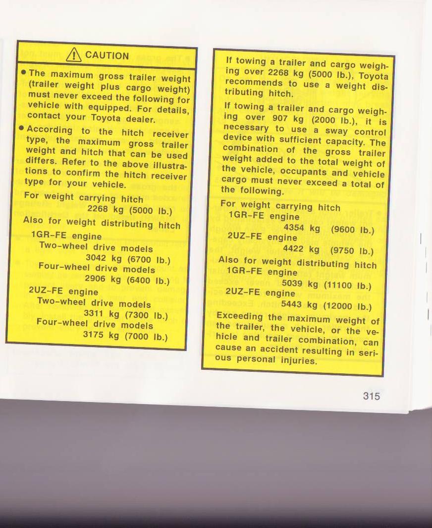

Yes, but some of you are missing the point about what is stated in the V6 manual.... that it states that to increase the towing capacity to 6700#'s you have to add an external tranny cooler and weight distributing hitch. This has been covered many times on this forum over the years, yet mostly in reference to the upgraded hitch.
Toyota is verbally contradicting what they have in writing. Since it is in writing in the manual, I think that would cover you in any court.
Has anyone contacted Toyota about what is written in the V6 manual? I'd like to here them explain that you can officially raise the towing capacity by adding the transmission cooler & hitch, but we don't recommend doing it. ;):
What manual and/or year 4Runner are referring to? Neither my 1999 or 2000 owners manuals say anything about towing except that the V6 has a 5000 pound trailer towing rating. There is no other information except that they want you to use a weight ditributing hitch over 2000 pounds.
I am not disputing that a tranny cooler could help improve your transmission's odds of surviving. I am only saying what my owner's manual says and what the Carmax Toyota service manager and the Annapolis Toyota service manager said to me.
Ok I have to correct myself to what I said previously because the manual does not state that the cooler is required just a weight distributing hitch. I scanned the page from the manual for everyone to see. The cooler is extra insurance though for sure.

That's interesting about the gen 3 4Runners requiring a weight distributing hitch for over 2000 lbs. I thought I remember someone saying that Toyota does not recommend the use of a weight distributing hitch with the hitch that comes on the gen 4 V6? (Something about that it would change the handling characteristics, etc...)
