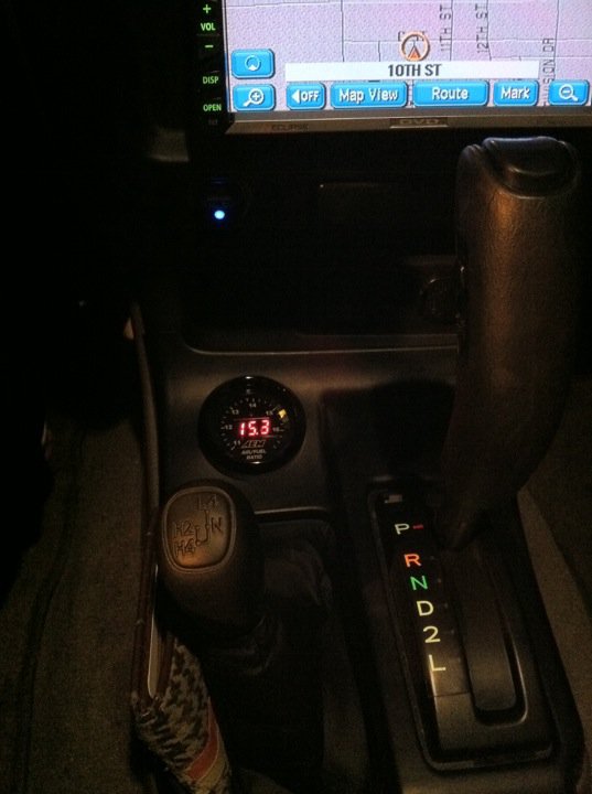

I myself am going with the stand alone because I like how they look installed in the shifter console. I currently have my AF gauge there, but I will move it and put that in a pillar pod when I get my tranny temp gauge. I know it's reading lean. My truck is not even on in that picture.
