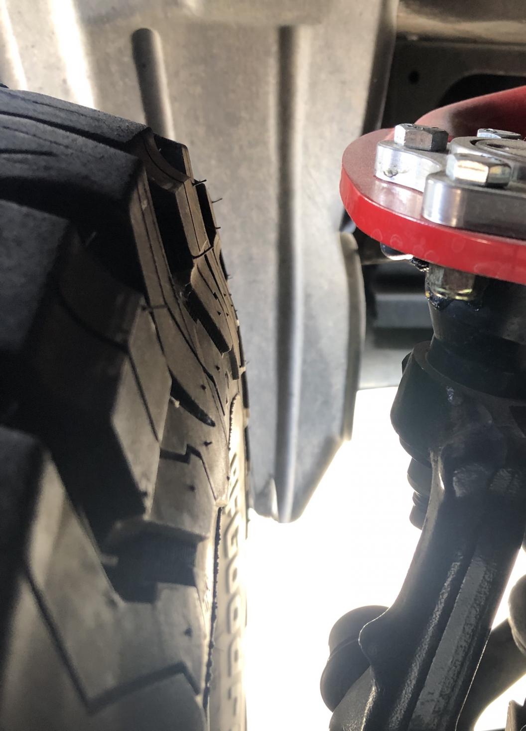

JBA Here. Very Solid. Running TRD Pro Wheels with 275-70 KO2's. No Spacers. Tire not close to UCA's
