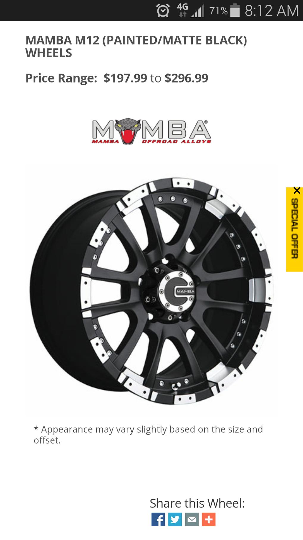

I am looking into getting the Mamba m12 20" x 9" wheels.
But not sure whether to get it in 0mm offset or 12mm offset.
The tire size I'm debating about right now is either 265/50/20 or 275/45/20
I have stock suspension, no lift.
I believe the OEM 17" sports edition wheel spec is 17" x 7" offset 30mm. Which is what I currently have on the truck.
I don't know if they will rub of not.

I'm hesitant to respond because its a 20, and I don't know how much difference that diameter and 9" witdth will make over a 17...
but as far as offset goes.....
You do understand that 12mm is about a half an inch right? It's not going to make or break you. I would go with the plus 12mm.
GL
alright, thanks.
i was hesitant on the 0mm offset, the only issue is that, i don't have a lifted 4runner and i don't want it to rub when i turn. but i do plan on lifting it in the future.
thanks again.

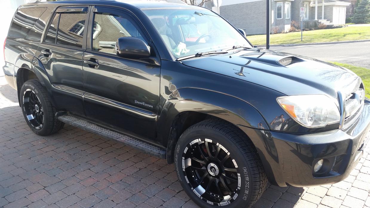

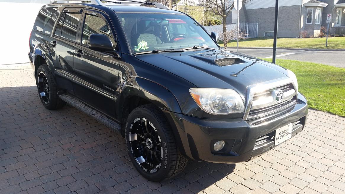

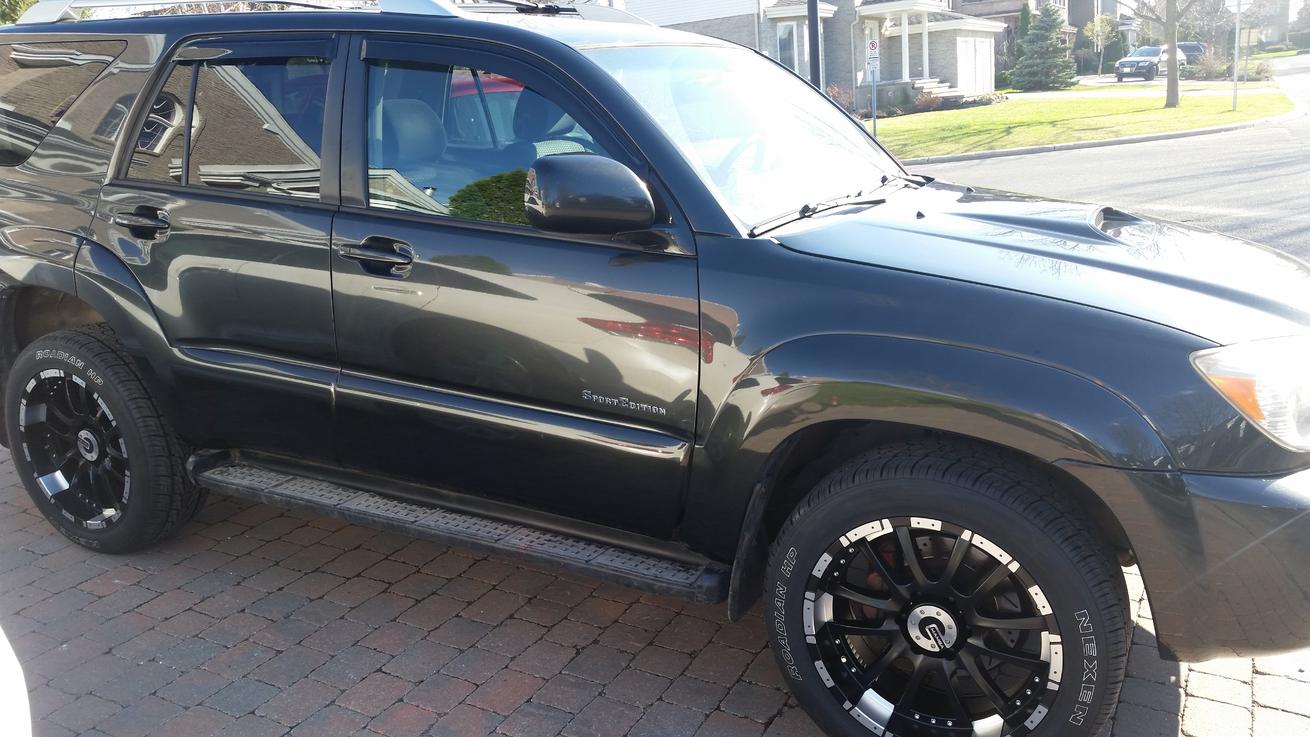

Any ways. Here are the pictures of how the wheels look on my 4runner.
