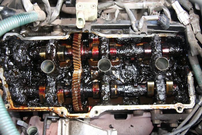

I get a call that they sarted in on the valve cover gaskets and found an enormous amount of sludge build up in the engine. I'm told it's not likely to last much longer like this and will need a new engine.
I'm given the option of a short block from toyota with a 12mo, 12k mi warranty or a long block from Jaspers (I think thats what they said) with a 3yr 100k mi warranty. I'm looking at between 9k and 9700 now.
Any advice?? Should I try and sell it how it is and just get out of it and suffer the loss? Fix the issues and bite the bigger monthly payment? I'm so pissed cuz the car is beautiful and exactly what I want.

Dealer recommending a new engine? Yeah I've heard that before. I have never heard of sludge issues in the 3.4L though and would be surprised if it were true even at 155k. IMO someone else should look at it so you can see what they think. That is a laundry list of big repairs which makes me suspicious. . .
With all due respect to any dealer techs on here, please take your 4runner to a reputable independent mechanic and get their opinion.
My b/f who is a mechanic at honda went over and took a look at it. It does indeed have sludge build up...but he's questioning their quick response of just giving up on the engine and suggesting a whole new one. There's no way to know how long it will still go.

Yes, some Toyota dealerships have a machine that forces pressurized mineral oil throughout the entire engine. The idea is to filter out as much crap as possible to make the engine as clean as possible. The dealership that I used to work had one of these machines and they proved to be very popular. You might want to call a few of your local dealerships to see if they have one of these engine flushing machines.

Yeah I saw and read that already. The sludge issue is not common, sporadic at best, in the 3.4L, although the 3.0L V6 did have issues. What is pictured here appears to be pure neglect and ignorance as discussed in the thread. Back on topic though. . . It wouldn't hurt to investigate options on cleaning out the sludge and weighing the benefits to the cost. Your engine is resilient and may be able to recover.
I talked with my boyfriend a little about this option, but havent asked toyota about it yet. There was something else he was saying you can flush through it...I didnt know about the mineral oil...but his concern was that it could cause "chunks" or whatever to break free and end up somewere else and cause a problem. Any experience with that?

I agree with the pure neglect. Its horrible. I know mine didnt look near that bad however. So I'm hoping there is hope it will still last me for a while. I'm investigating the cleaning out options.
BG makes a pretty good engine flush kit. If possible get a couple of those, use one then drive it for awhile. Use the second one a month or 2 later. You will probably be using a fair amount of oil at this point because your oil control rings are now gummed up and collapsed. If you have the money and you feel your 4runner is worth it you can have the heads removed and thoroughly cleaned and made right then have new rings and bearings put in. If you lived in cali I would either want to buy it from you or do the work to fix it

I'm an ex-mechanic, so I'd sure do it. But keep in mind that you don't have to remove a valve cover to check for sludge. Simply removing the oil fill cap usually does the trick.
Yes, but that's the reason that the engine flush machine runs under pressure. Actually, it is hooked up to shop air (90 PSI) and it does a great job of dissolving sludge and removing it. In your case, I'd run the machine through at least two cycles to ensure that everything is dissolved and removed. Each cycle uses fresh oil and new filters in the machine.

No comparison at all. The mineral oil is heated and combined with detergents that are specifically designed to dissolve sludge and remove it under pressure. You'd be amazed at the crap that comes out of a normal engine with this machine, much less your sludge monster engine!
As for the price, it used to be about $100.00 about 10 years ago. I'm sure the price is higher now though...
