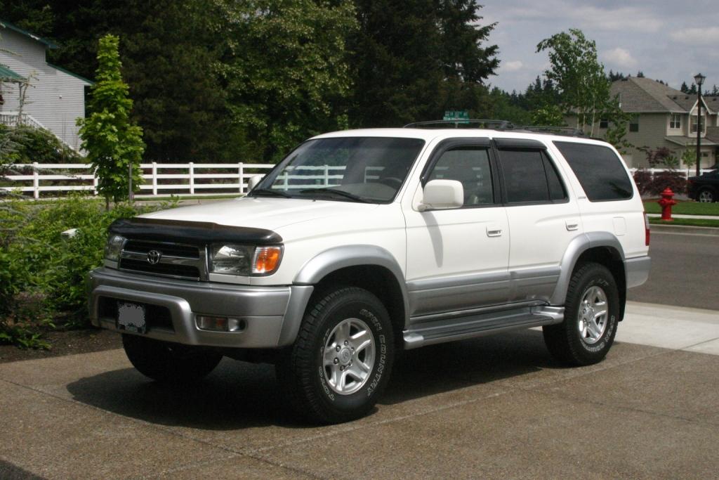

So just got the 4runner back from the shop today. I've had all this talk with nothing to show for it, so I thought I would pass on a pic of what I've fallen in love with. Toyota took care of leaking valve cover gaskets, leaking power steering rack, and timing belt/water pump/seals. Its driving just fine for now. Since I havent had it long enough to really check the mi/gal yet I'll be keeping an eye on that and the fuel gage...as I've read about some issues with that.
I'm going to have my boyfriend help this coming week with doing something like Charlee78 suggested and/or using some BG product like toytech brought up. I'll let you know how that goes. Thanks guys for all the advice. I really appreciate it.

Nice ride, looks very clean!!!
Keep us updated!
