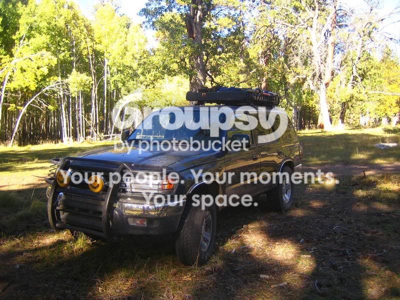

Anyways, we are totally in love with our SR5. It's got power everything, sun roof...I added the tow hitch package and other accessories. It is just about to turn over 150,000 miles and the only repair I have had to do other than scheduled maintenance is the rear axle seals, and the radiator has a tiny leak in one corner that I will be fixing this winter.
10-7-07.jpg~original
