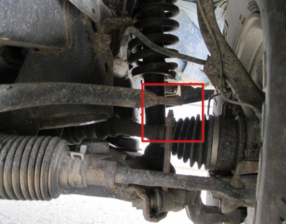

I was under my 4Runner, taking the running boards off (finally! more on that in my build thread) and I noticed that a part had popped off, leaving this part loose. I have no idea why it is like this, or how long it has been like that. I may have even just driven across the country on it!
See picture and what is this called? Is it safe for me to drive it to my mechanic (30 miles)?

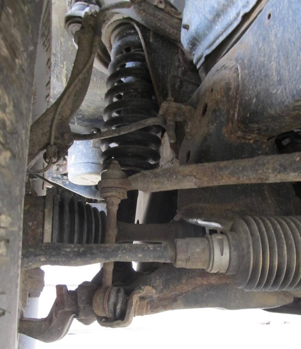

The picture with the red square is on the passenger's side. The other photo shows the assembly like it should be on the driver's side...
THANKS!

Broken sway bar end link. It's fine to drive it like that, It just won't handle as good.
Is that expensive to fix? ohh, so that's what the sway bar is, I know people take that off sometimes... Should I go to the dealer to get this fixed? Will they have the part on hand?
Thanks, am relieved to hear this! :) (i.e. nothing too serious)
Oh, and it's ironic that your nickname is KSWAY :D in the context of this post.
Super easy to fix. One of mine rusted off not too long ago. 25 a piece at autozone. Do both sides while you are at it. Takes 30 minutes tops to replace.
Found mine like that when I went to put the lift on the truck! I think the sway bar links are like $35 each at NAPA. Not very expensive, and easy to replace!
Thanks guys for all the info! Looks like I'll find some locally or order some online and do it myself!
