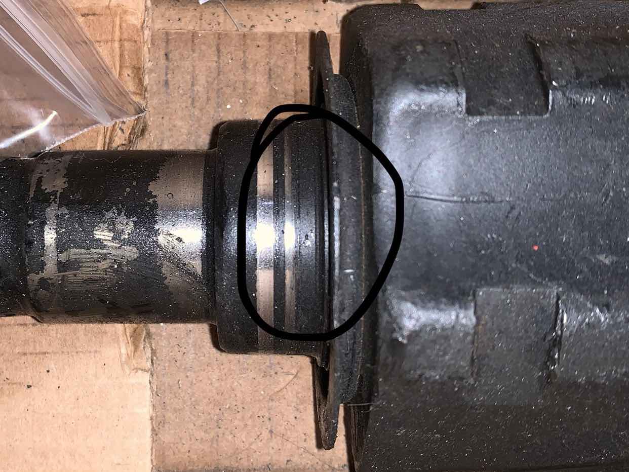

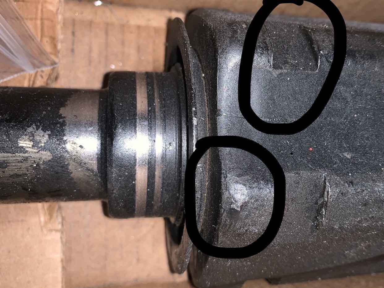

I’ve replaced more CV axles than I care to remember and have always used a pry bar. As long as it’s a big one with a curved end it’ll pop it out no worries. Just have to get between the actual lip of the cv axle and the differential. I can almost guarantee you thought you had it in there but it has a lip that you can’t really see. I’ll take a picture of a spare one I have in the garage in a minute and post it.
EDIT: ok this is what I mean. You were probably prying here, which gives no leverage. These notches can be used to pound on with a flat wide chisel or big flat head screwdriver and a small sledge, but that’s harder due to no room under the truck to swing. IMG_1895.jpg
If you can get the pry bar behind this lip, it’ll pop right out. Just be careful to not poke up in behind that lip too far as you’ll damage the differential oil seal. Use a pry bar that has a curve to it or a large flat head screwdriver and it’s cake.IMG_1896.jpg
EDIT: ok this is what I mean. You were probably prying here, which gives no leverage. These notches can be used to pound on with a flat wide chisel or big flat head screwdriver and a small sledge, but that’s harder due to no room under the truck to swing. View attachment 341373
If you can get the pry bar behind this lip, it’ll pop right out. Just be careful to not poke up in behind that lip too far as you’ll damage the differential oil seal. Use a pry bar that has a curve to it or a large flat head screwdriver and it’s cake.View attachment 341374
