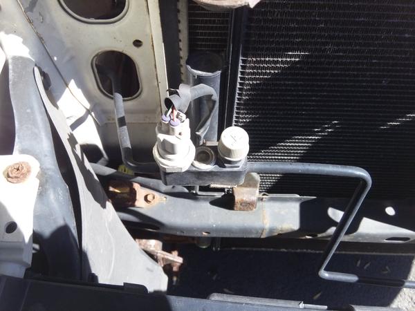

What's this in front of the radiator?
karyins
The other day it had a bubble in the little round window so I thought oh it's a bubble level! Today it seems dry or it's filled with liquid.
What is it anyway? Kinda curious here...
Thanks!
Ac freon. Look through it when ac is on(Compressor running). Foaming bubbles indicate low freon. Clear is full.
