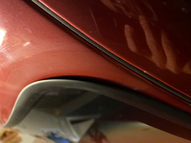

Regarding windshield seals, I just noticed mine peeling away driver side at the top...
Driver's side? The most likely cause isn't the windshield, but the rubber grommet where the wiring from the engine bay comes into the cab.
Water literally POURS over that rubber boot when it rains. If it is at all out of place or has aftermarket wires run through it, it will leak right into the cab.
