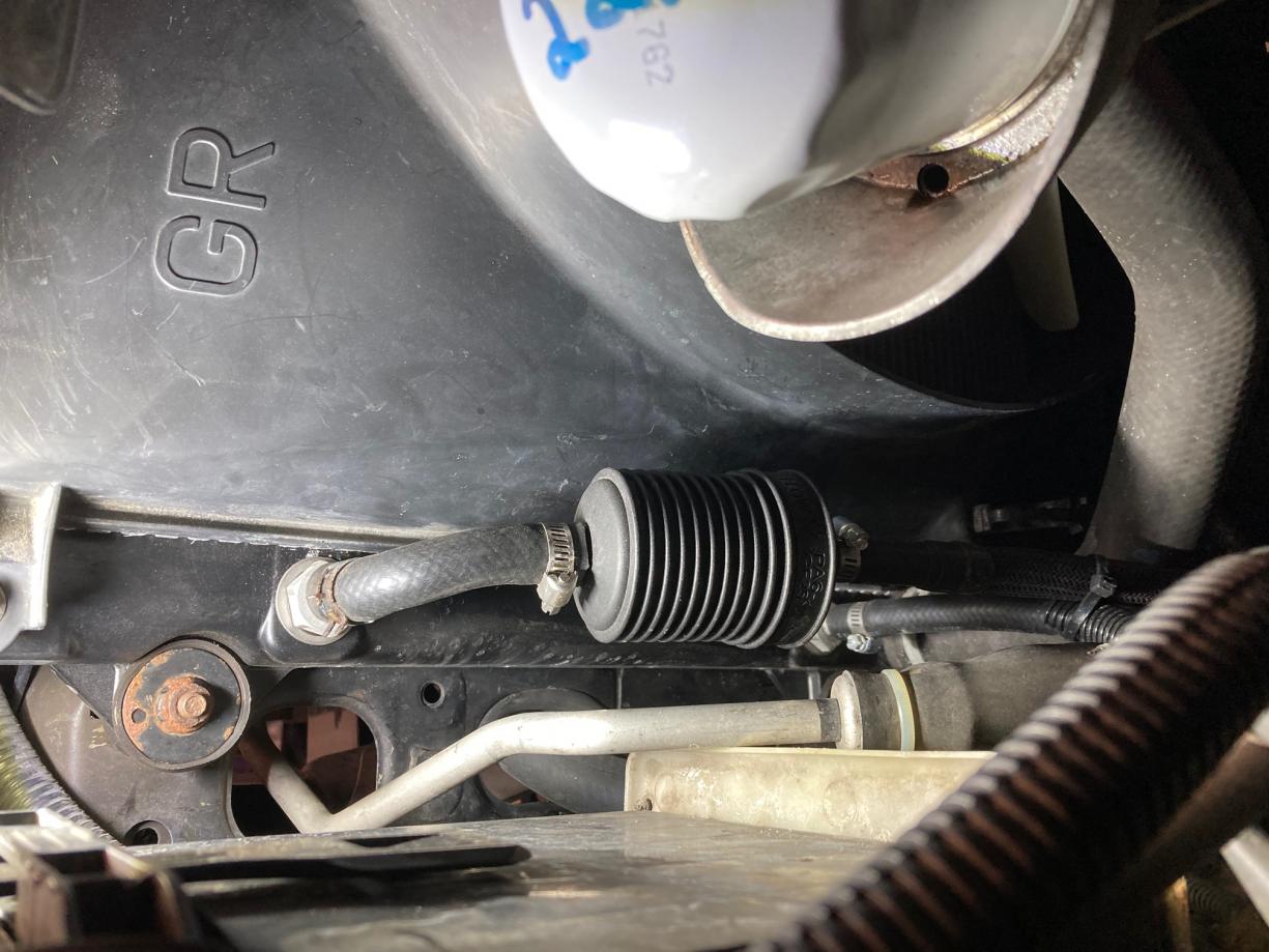

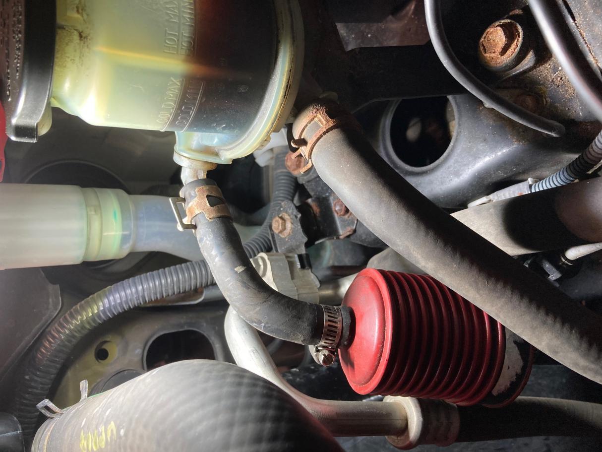

Thanks. Is it necessary to top off the fluid level after changing it out? Also, where is yours mounted?
I have one on the transmission line top of radiator and power steering return line to reservoir. They are so small there is no reason to top off the fluid.
