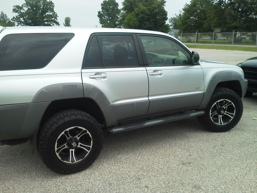

I had the same thing going on my 2003, Here is what I did. I installed daystar 3/2 level kit, 265/65/r17 duratracks on xd cranks rims. The only mods I had to make were removing the front mud flaps and move the inner fender in a half inch. hope it helps.... IMG_20140610_115906.jpg
