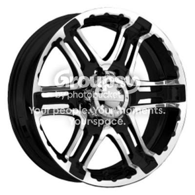

Ideally, I'd like to get rims that stick out about 1" further than my stock 17" SR5 wheels. I've read threads such as this: http://www.toyota-4runner.org/4th-gen-t4rs/31395-backspace-offset-replace-1-25-wheel-spacers.html, but am confused..... Feel like I need to go get a math degree here...
Will these get me what I want our not?? I if not, anyone have any suggestions for some good looking wheels that do? I'm planning to just buy a package (wheels/tires) online with the TPMS already installed.
http://www.discounttiredirect.com/d...06&pc=61028&counter=1&wd=17&rw=8.5&vid=010152
Thanks!!

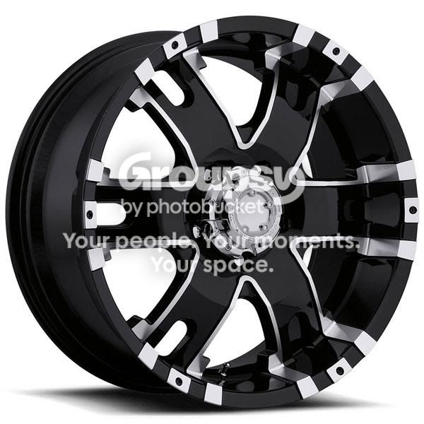

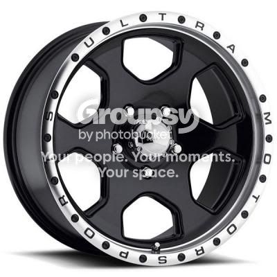

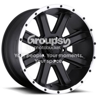

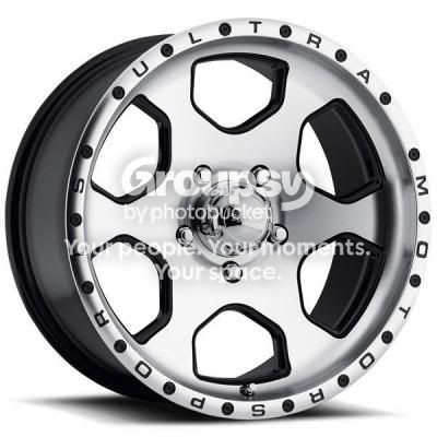

Thoughts on which is better looking? The Phantoms are brand new - thus I really can't find any actual mounted images of them..
Ultra Barons:
19452.jpg~original
Brand new design, Ultra Phantoms:
ultra_phantom_mba_ci3_l.jpg~original
Thanks! Any other suggestions are welcome
backspacing ?
Dude not to really blow it all up & not knowing your budget have you checked out 4wheel parts they are having a sale on their procomp stuff & there are quite a few that look like these & more , just saying ! I don't work for them just like their stuff .
I'll look into them more tomorrow for sure. I was looking at performanceplustire.com actually, but I see the deals you speak of my good man. Thx.
Sorry I hate the machined cutout look on black. Too busy.
On the second ones - right? If so, I think I agree. Sad thing is the first one only comes in 17x9 +12 offset, which will work, but isn't ideal like the sizes for the second. You might be taking about both though..
I'll keep looking and post ones I like here for opinions. Lol

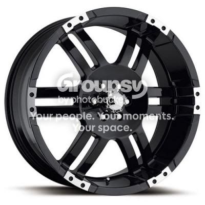

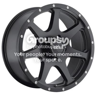

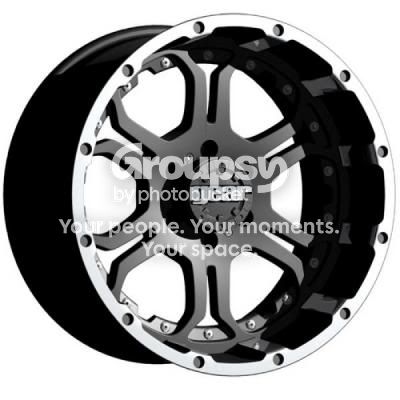

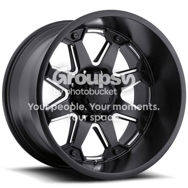

Other top runners (not necessarily wife-approved):
14229-1.jpg~original
19474.jpg~original

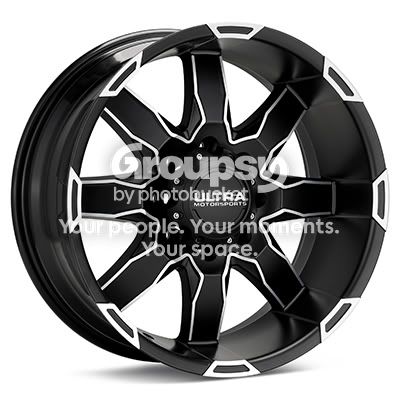

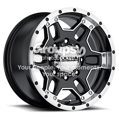

And this is the 8 lug version of the Ultra Mongoose, only because it seems like they have done like - 50 offset deep as he** version of the 6 lug on their website..
Ultra_178-500.png~original
19456.jpg~original
