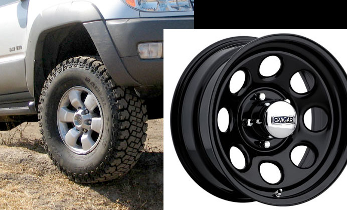

How wide are the rims? Stock 3rd gen rims are 16x7 and have a backspacing of about 4.625. If you stick with the 265 series tire then you should have no problems. They will possibly look a little more tucked in than stock, but likely not noticeable. If you move up to a 285 series tire then you will most likely rub on the upper a-arms and also on the frame at full-lock.
Ok well if all you are worried about is fitment then just don't go over a 10.5" wide or 265 series tire and you will be fine. If you can find the same rim, or another that you like in 4-4.5" backspacing those will work down the road if you decide to go to a wider tire.
I have 4gen 4Runner running 285 on my stock 16x7 wheels.
I want steel wheels 16x8 on CRAGAR but only find 5" backspacing and +12.00mm offset.
Can I run those? it
