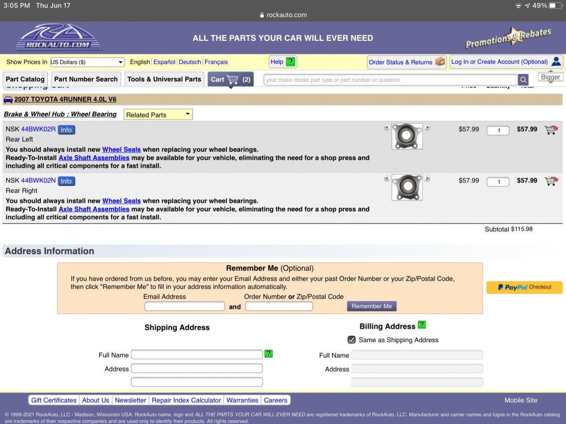

Left and right rear bearings NSK best value

I dont know why but the same NSK rear bearings are $58 each. Half off

Seeing as how I'm doing this myself to save money, I don't mind spending a few extra bucks quality is better. Are those NSK equal to or better than the Timken bearings HA594246 and HA590050? For the seals, can I get those from RockAuto? Part numbers if so? I would very much like to purchase two of the retainers as well, are those the "SKF CIR270 Snap Rings" on RockAuto?

Timken uses chinese bearings. NSK makes better bearings IMO.
