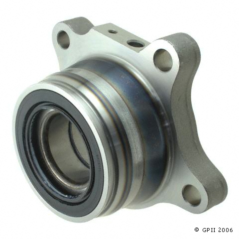

i have yet to actually work on one, so I cant verify. but my parts system shows a HUB style bearing for the REAR also.
has anyone on here ever changed a REAR bearing, and can confirm or refute this?

I've done some research on that too. I believe that is the right part, but it still has to be pressed over the axle. I'll find out soon enough. It's on my short list of things to do this summer.

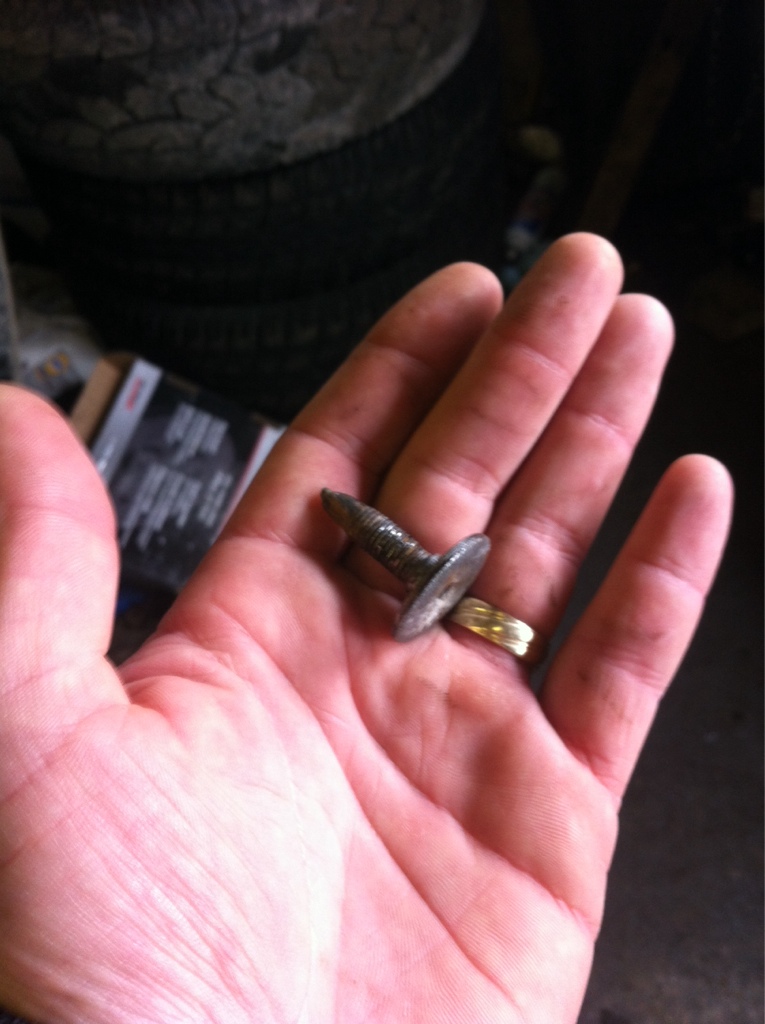

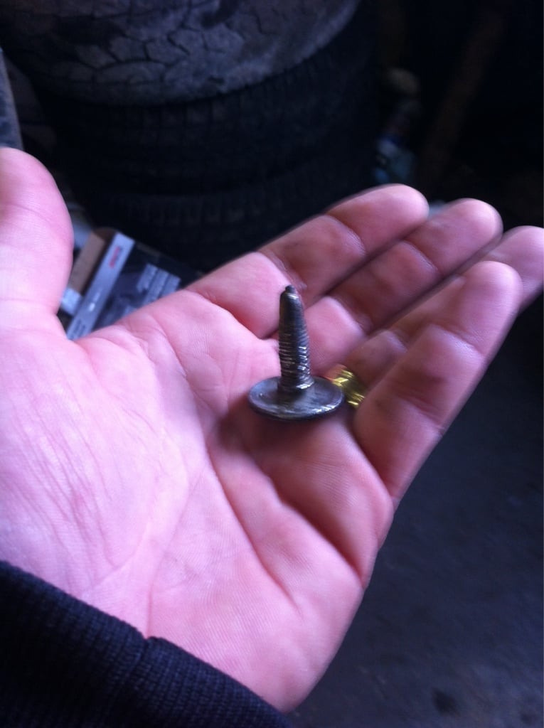

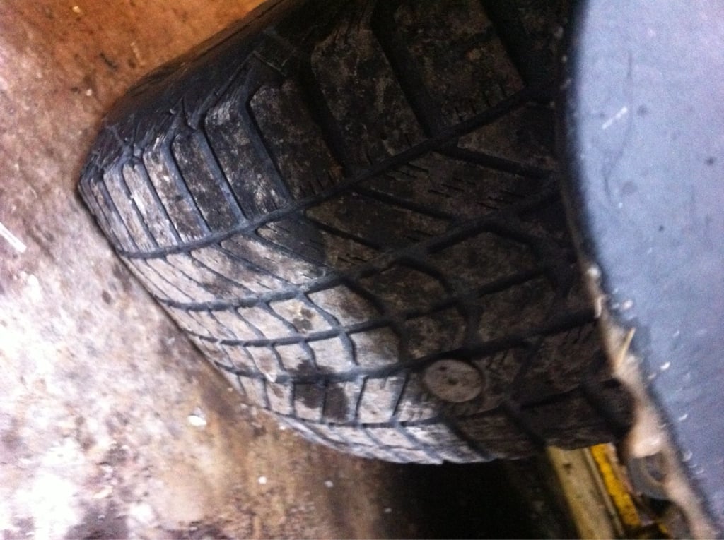

It doesn't sound like it could be a bearing problem. I'd take it back to the shop that did your axles.
So I found out what the clucking sound is, lol it was the rear. Before I took it back to the shop I checked the rear out. Look what I found..... Turns out that trail I was on today had a left over sled track spike that my tire wanted to take home.
I threw a plug in it

yeh, that's how my 85 is. but according to the pic I posted above, the 06 is different. its a complete unit, that looks like it bolts in place.
