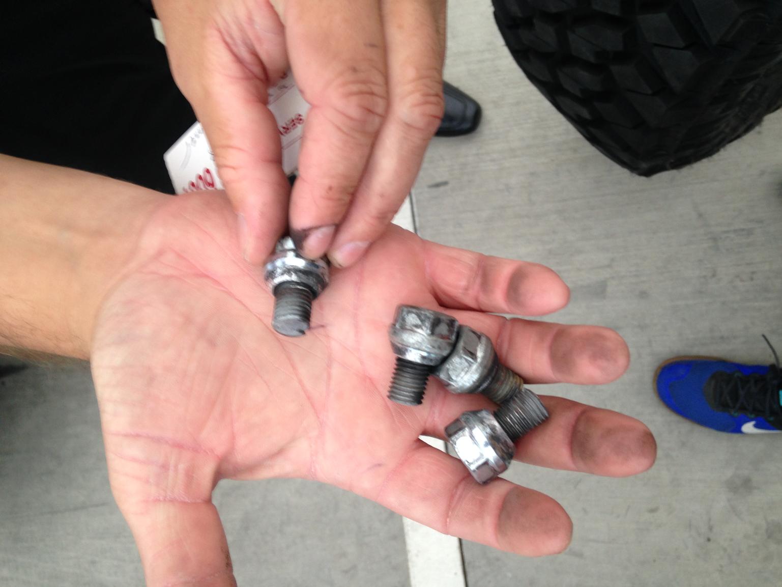

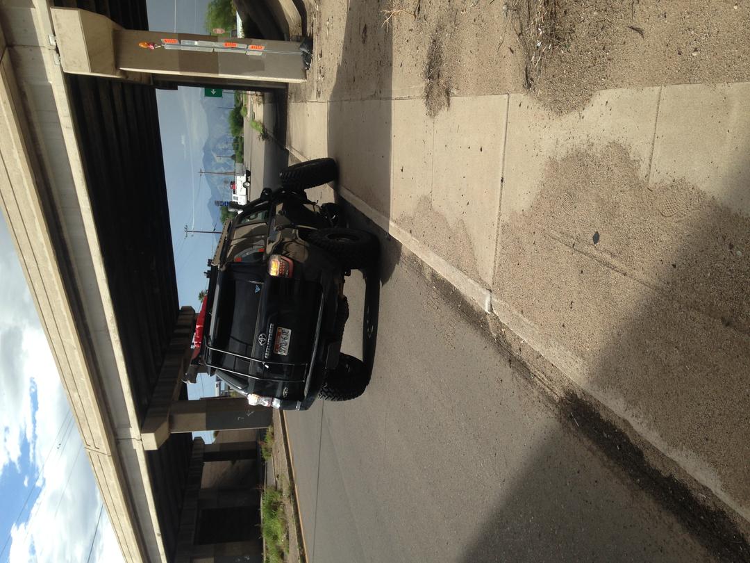

A couple of months ago my wheel came off while driving south on the I-10 from PHX to Tucson, I was going about 75mph, felt the entire car shudder and immediately made a b-line for the offramp. As I am slowing down coming off the freeway the car lurches forward and I watch as the passenger side front tire and wheel fly across 4 lanes of traffic in front of me. Being the idiot that I am I though, "dang, thats a sweet looking wheel and tire set...oh wait....thats the same wheel and tire set I have...ohhhh, thats my wheel and tire."
Most important outcome of this accident was that no one was hurt and no one elses property was damaged apart from my own.

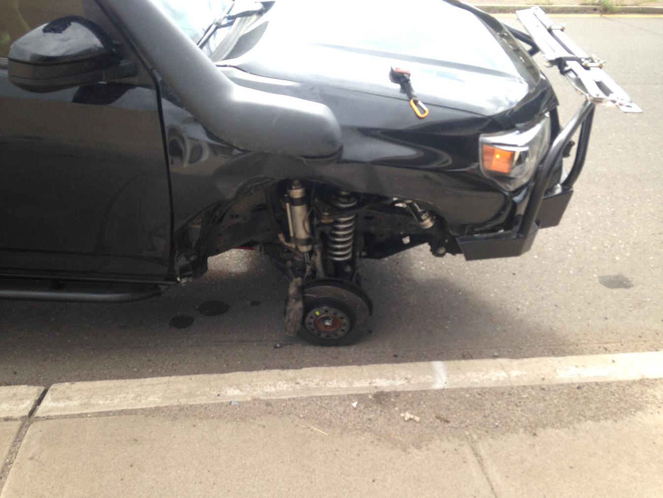

After several investigations by two major insurance companies and two toyota dealerships, the cause of failure was that all lug nuts snapped clean off due to improper torque, I was running 1" spacers at the time, but the spacers and spacer lugs stayed bolted to the wheel with no sign of spacer failure (multiple engineers from Toyota and insurance companies confirmed that while the spacers place added leverage force on the factory lug nuts, the factory lug nuts would have failed either way due to improper torque applied, the factory lugnuts were seriously under-torqued).
Just a couple of days before the accident I had a local offroad shop in Mesa, AZ, put on new wheels and tire, work on clearance issues, firewall tubing, welding sliders, bodylift, etc. The night I picked up my car they were bolting the wheels on in the parking lot with a hand drill and rushing to finish up. I should have checked the torque on my own wheels/ made the shop torque to spec with proper equipment. This was my mistake.

I am surprised to see you say it was too little torque! Looks like the sheared studs would have happened from way too much torque.
I learned that these trucks only require 83 ft lbs early on. I took the truck to tire shop to switch out dunlops to duratracs within 1,000 miles of purchase. Watched the kid use a pnumatic gun and i said something to them only to get a bs response that it had torque control or some nonsense. Upon inspection i found 2 completely sheared studs and a third that was very stretched.
I have "83 ft lbs ONLY!" written on my wheel lock in sharpie and covered with clear tape to protect the writing. Have not had a problem again with that reminder on there. Also i have seen discount tire receipts that show 85 lb ft as s the reminder to the tech.

Damn this sucks but glad you're OK. Have you checked the other 3 for damage or failure? What did the shop that did the work have to say about this?

Glad you were ok. How did it feel driving on three wheels? Did the front end stay up till you got to the shoulder?
When that wheel came off the car was completely out of my control. Front end dropped and pulled me right onto the side of the road, luckily it was not drivers side which would have pulled me into oncoming traffic. At the speed I was going I pretty much just held on best I could.
Absolutely agree with your thought; that is what I thought as well (I am not an engineer or anything close to mechanically competent). However, both insurance companies and their engineers claim it was too little torque that caused the wheel to basically 'walk' itself off the studs and give enough room to apply vertical force which lugs are not designed to handle. (had to reference my insurance documents for this response to make sure I am giving out the right info). I have no idea how they determined that.
At this point it does not matter what the real cause was, all that matters is what insurance says it was, unfortunately.
You very well could be right, and too much torque is a much more common scenario/problem.
