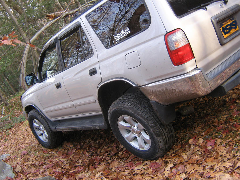

He's how I used to look with 1.5" wheel spacers to kick the tires out. I love the sport wheels.
