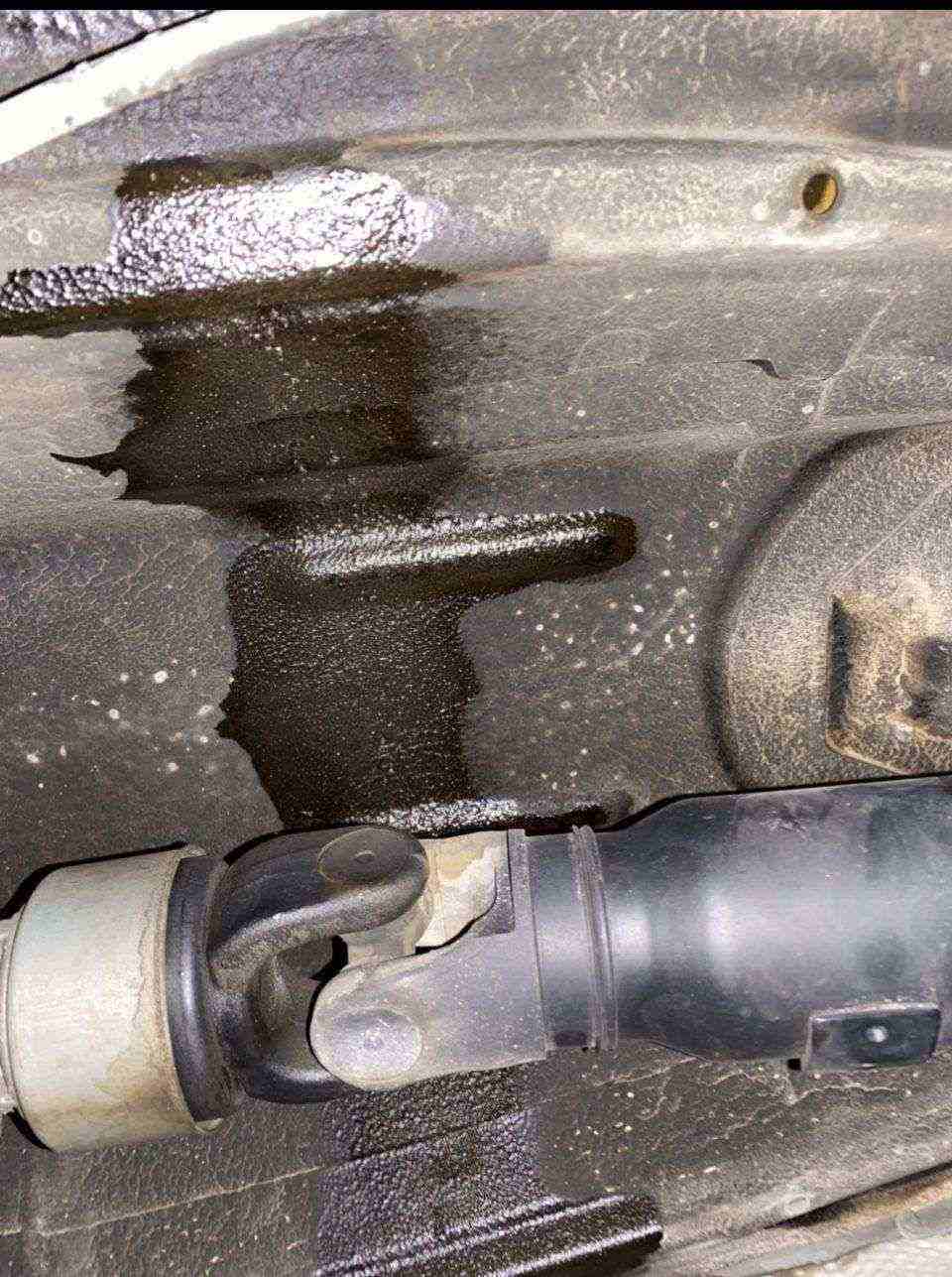

Ah, the plot thickens. Now chasing a failing U joint instead.

Not fully confirmed. After searching many videos for similar sounds, have a list of possibilities. Although I can’t manipulate the u joint physically, the fluid spray is an indication. I’m also planning on swapping out both front wheel bearings and the parking brakes.
Being the u joint May also be the reason I can’t pinpoint which side the sounds is emanating.

***update***
Swapped out both U joints and found both originals to be dry in a couple of the caps. The pins were beginning the burnish into the stems. Also found a bad wheel bearing on the driver side and swapped the out. No more clicking! For certain it was the front u joint making the sound.
