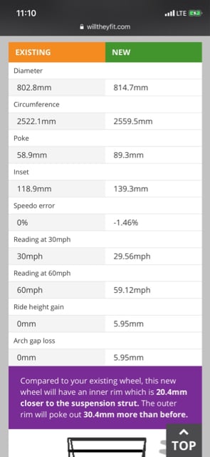

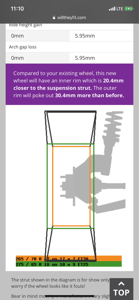

Ok so new to the 5th gens I bought a 14 SR5 and need to do wheels / tires. I’ve ran the Goodyear Duratrac because they have been absolutely awesome on my 3rd gen with over 80,000 miles on my first set and still had many miles left. So my question is wheels. I’m looking at 2 different setups the one staying with closet to stock dimensions on a 17” wheel I’m not worried about but my second option is going with a 18” wheel in 18x9 and wrapping that with 275/65/18. The offset is +25 backspace is 6.00” will the 18’s clear without a lift ? 98% street with the occasional summer trip to the sand dunes in Michigan. Just worried it may be too close to the upper control arm or body mount. Anyone have any experience with a similar setup
Yes I’ve read that the tire size isn’t the issue the backspace and offset of the wider wheel is the issue. I’ve looked in the other links and don’t see anything that showed that it will or will not clear.
