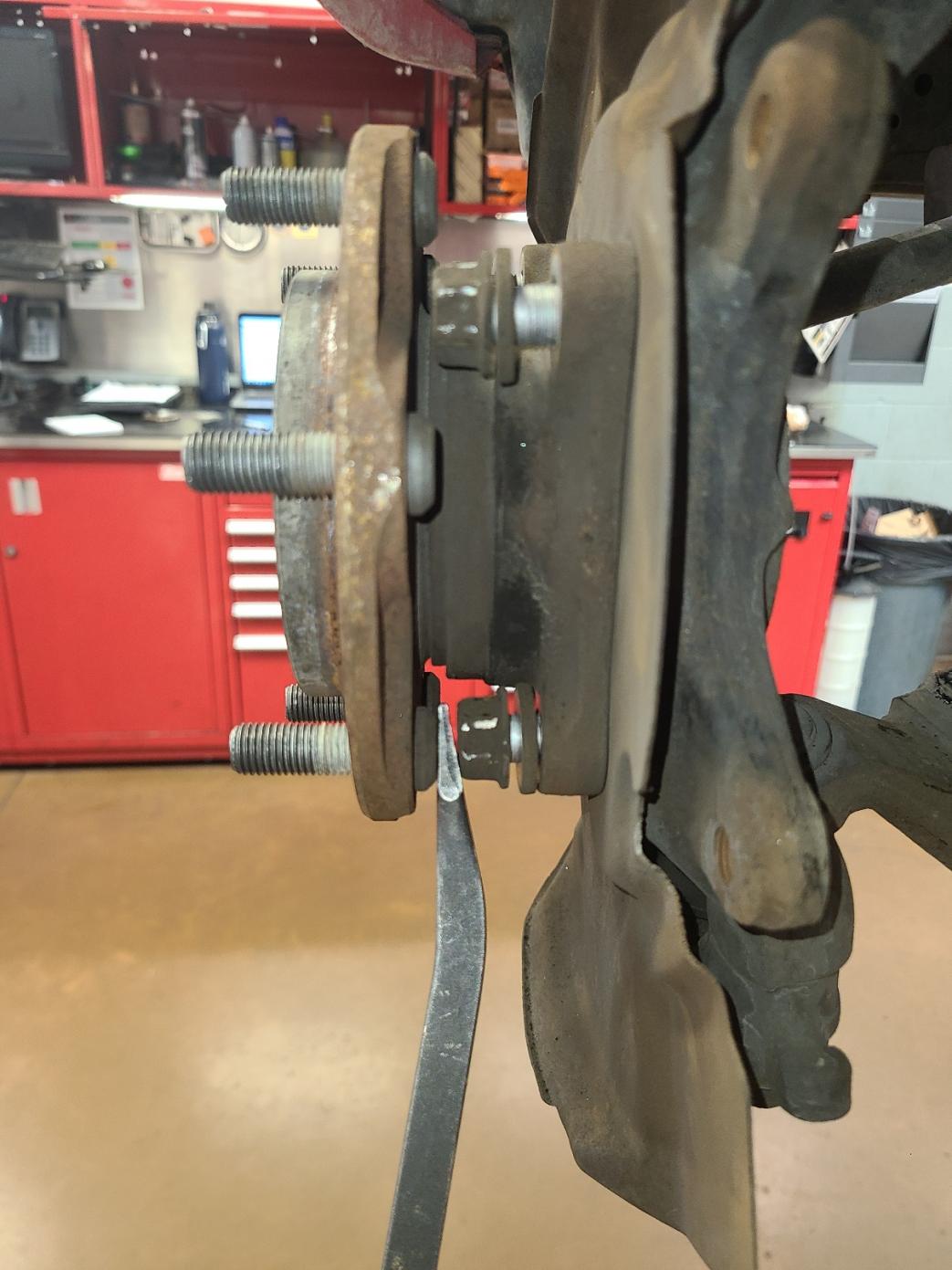

Thread in the 4 retaining bolts for the hub assembly back into the spindle about 3-4 threads or enough that you can spin the hub without hitting them and still have about an 1/8" gap between the back of the stud on the hub and the bolt. Get a large pry bar and wedge it between the stud and bolt and use that to pry the hub out of the spindle assembly (pushing into the bolt which is your spindle fulcrum point). Do this in a cross pattern slowly and carefully to "wigggle" the hub out of the spindle. Was a trick a coworker showed be and works way better than a hammer or slide hammer most of the time.

For posterity, here's a picture of what a couple of us were talking about (was doing a PreRunner wheel bearing yesterday that was a bit crusty and remembered this thread.)
