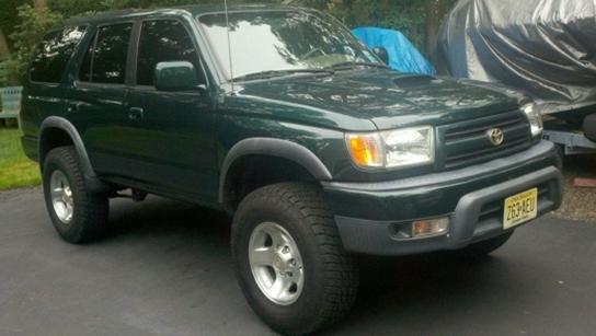

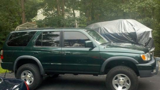

Hello Guys,
I'm trying to determine which wheels are on my 99 4Runner. IIRC the person I bought the truck from 6 years ago said they were Land Cruiser wheels. I'm seeing a bunch of rims for LCs, fj80, etc but I'm not sure what the differences are.
Any help would be appreciated.

Those look like 1993-1998 Toyota Land Cruiser "machined" aluminum rims which are usually 16" x 8", 6 Lug, 5.5" Bolt Pattern
